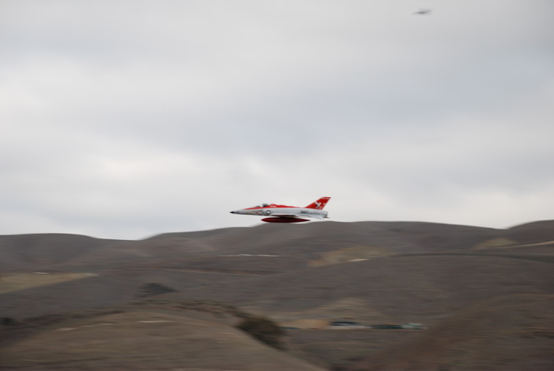

Yup,
Maidened my BARF with tailerons and a titan! What to say...hmm
SPECTACULAR!!
Frankly, I couldn't tell the difference between having tailerons vs not. I couldn't even tell that much of a difference with the drop tank.
But I could tell the difference between the Titan and the 120. Wow. Can I say accelerate vertically? Yes, I can!!

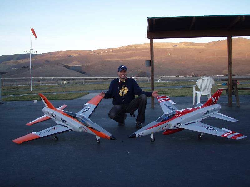

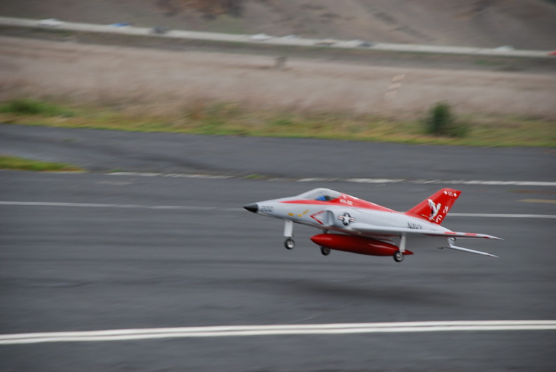

Here are some more pics!
Thanks Dantley for taking pics man!
The orange Bandit has a 120 no tailerons, the razor back has a titan, drop tank and tailerons.

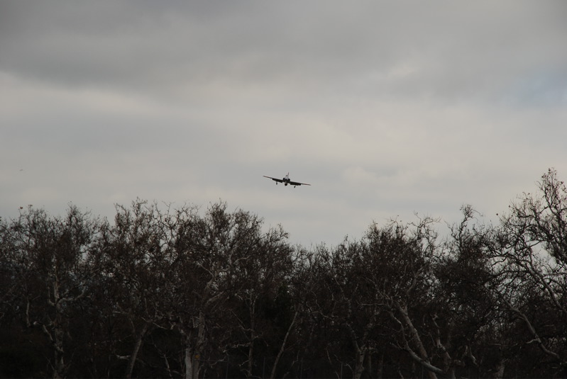

Here's a pic of a dirty Bandit on final! Such a dirty bandit!!
David, I don't quite get what your talking about. I thought my canopy mated fine....Let me take a closer look!

Oh, I think I see that the front of the whole upper portion seems to pull off of the nose. It is most appartent on the pic with the high vis/smoke.
I don't see how this could be. On the ground that front end is tough to pull up...[] I better pull harder!

ORIGINAL: ravill
Raf
Yes its the orange/white one. I think if theres even a small gap in between, air will flow below it and cause it to lift. Transparent tape will work fine too, to block the air flow.

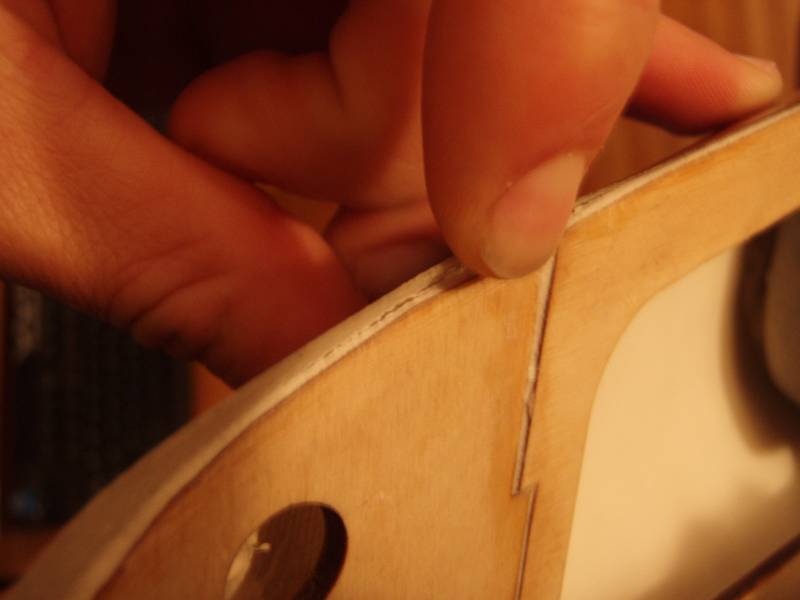

I found out why the front of the top part pulls away from the fuse. The glue that holds the fiberglass to the plywood formers sucks. It is not hysol and it just pulls away with any type of pulling.
Just placing the top cover on the ground with a little sideways force and the fiberglass pulls away from the plywood former, requiring more glue.
This is a crappy design. I can see why David used srews all the way around. It is really annoying. I might have to hysol all around. I'll post some pics when I get home.

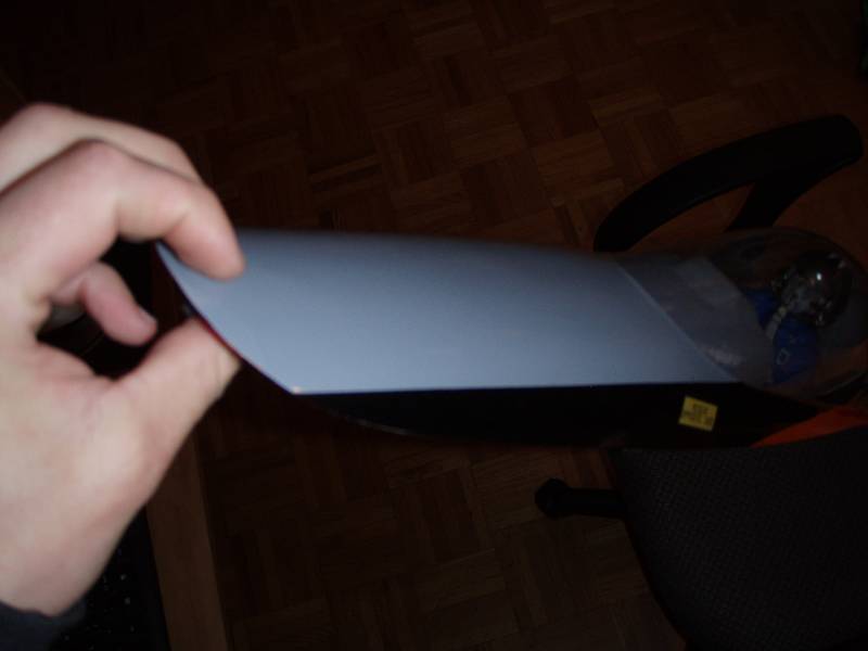

Here are the long awaited pix.
I was just going to show the fix, but after just picking up the top canopy (to take a picture of it), the fiberglass separated from the wood liner. So, the good news is that I got a pic of an actual separation and the bad news is now I've got to fix it!
