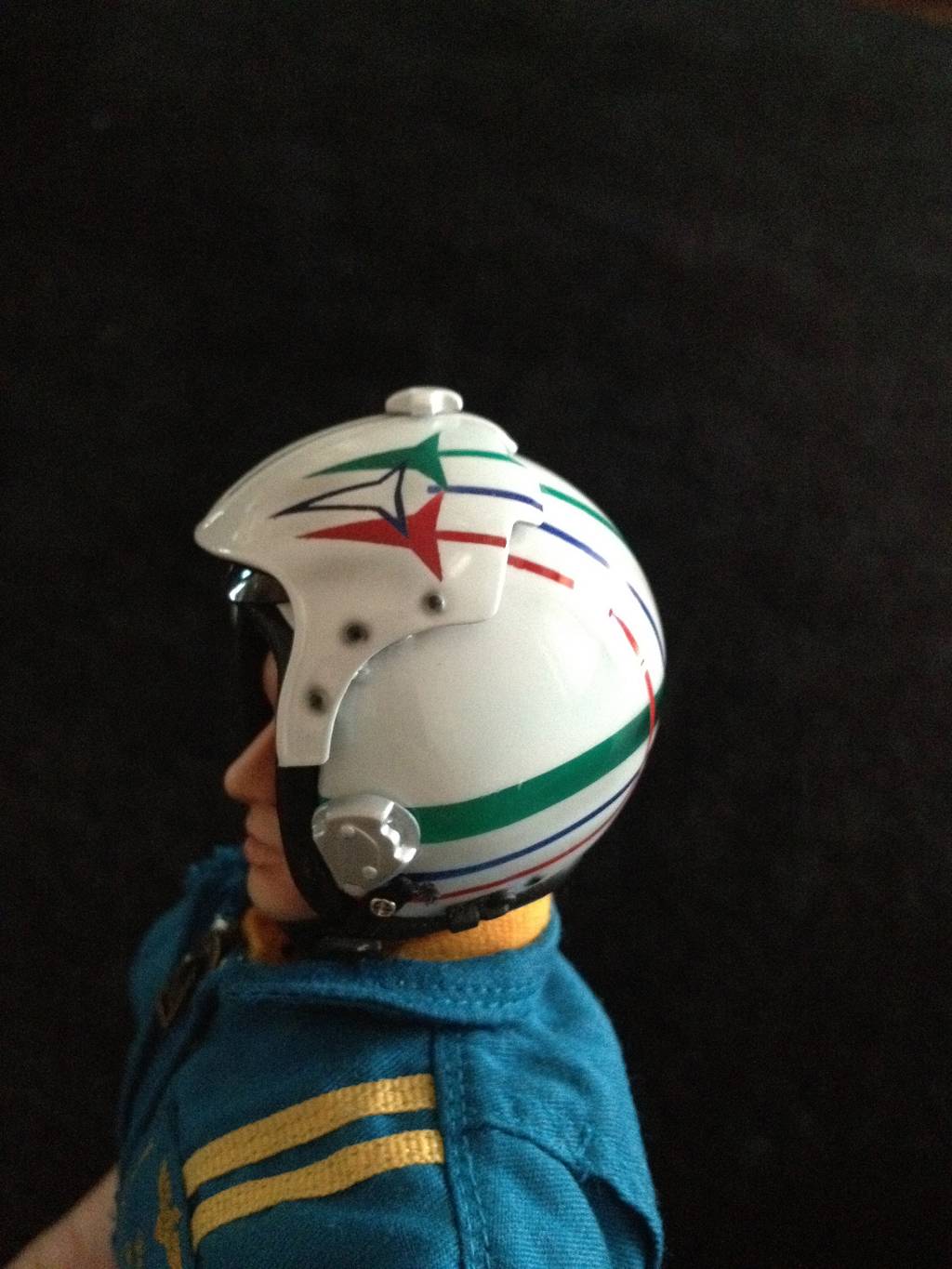

This is my pilot for my SM - MB-339 Fricce Tricolori.

Bruno, gorgeous! How did you do to get the pilot clothing and helmet detailing so nice?? Which scale is the pilot (1:4 or 1:5)? How long is the pilot in cm?

hello this pilot and I ordered the Blue Angels paint the helmet with the model of the Frecce Tricolori.

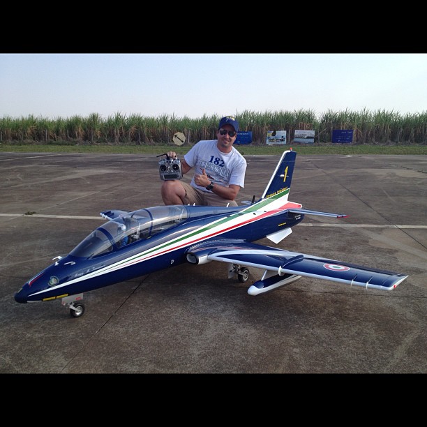

My MB-339 Frecce tricolori!!!

Bruno:
Congratulations.... beautiful plane. Were did you get the details like antenas an pitot tubes ?
Old 10-06-2012, 03:36 PM
  #321
bruno borges
Join Date: Mar 2010
Location: Sao Paulo, BRAZIL
Posts: 251
Received 10 Likes on 7 Posts
Default RE: SkyMaster MB339 Build Thread
Hello Gonzalo,
The Antennas e Pitots, Im buy in the Details4Scale.
Bruno
