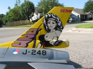

I have had excellent results from Aeroloft. This plus many more.
