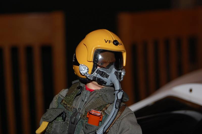

I am not rearly that good at scale details and I certainly was not going to buy the Tamjets scale cockpit so I thought I would have a little go myself. I am happy with the result on this sport scale jet

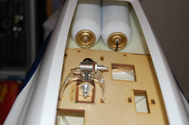

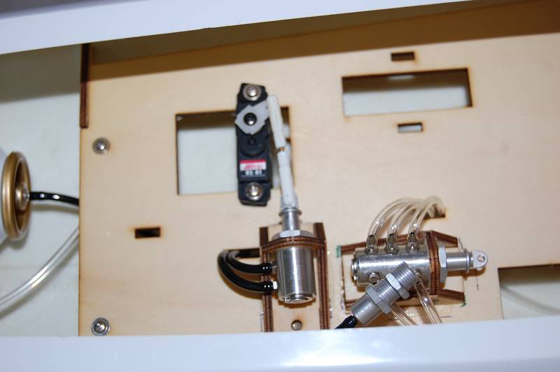

Here is the completed air system installation, Waiting for servos.
Nice and neat! Black for Breaks, Clear for Gear!

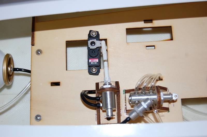

There is a slight bend on that retract pushrod you need to get it perfectly straignt or those valves can leak and loose all the air cos they are slightly at an angle in the barrell. Dont want to have to belly land her cos all your air has gone.
Dennis

That one is breaks, and i have placed the valve Push Pull lever horizontal, so a little side to side movement is ok. I have tested it and it seems to be ok. I will bring it round when we run the Wrens, and you can have a look. i will do the main U/C valve next!

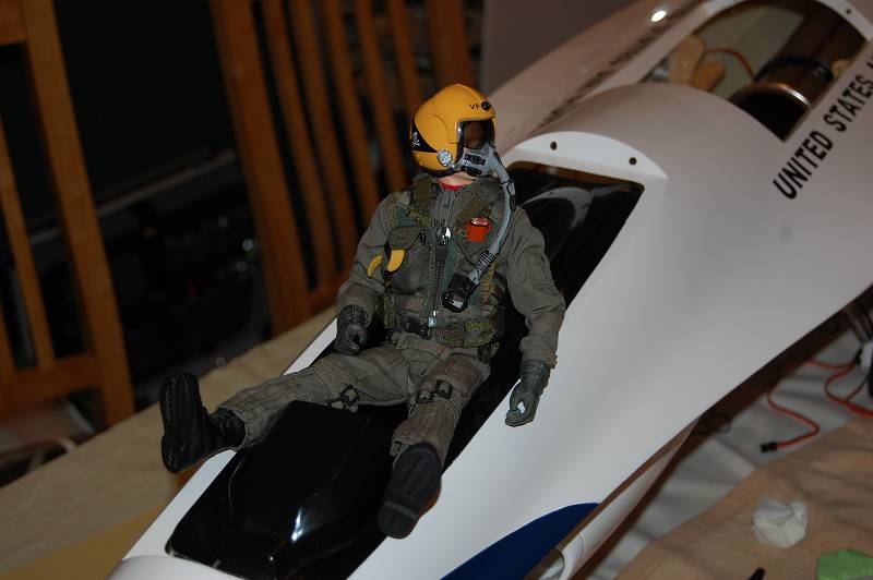

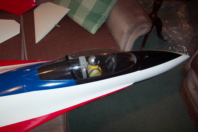

Look what turned up in the post this morning!
May have to re think the cocpit layout, Or in the words of BigPlumbs,"Turn him into douglas Barder".
