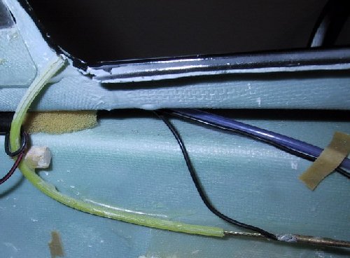

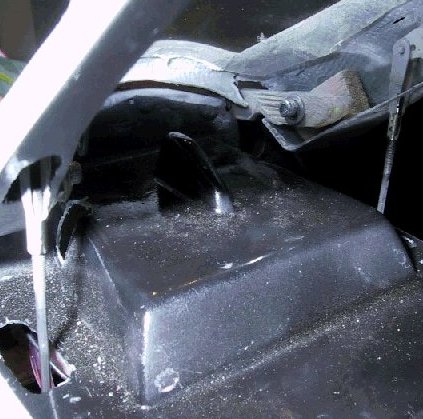

here's a few pics as requested.
Please note that I was more interested in functionality than pure scale on this canopy. If I would have been more patient I probably could have made the hinges better looking and a couple other things. But since this was my first opening canopy attempt, I was pretty happy.

Old 03-09-2002 | 10:31 PM
My Feedback: (13)
Posts: 101
From: Dallas, TX
Default Opening Canopy
Canopy lock
Note the wire which connects to the cable. Whenever the canopy is down, I set the canopy to lock. This closes a circuit to a 9V battery and spotlight. let's me know the canopy is really locked down when I'm taxing...

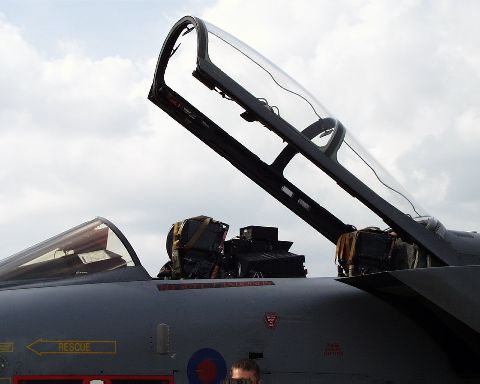

Old 07-13-2002 | 10:43 AM
Countryboy's Avatar
My Feedback: (25)
Posts: 2,657
From: Lawrenceburg, KY
Ken,
If your existing canopy is just a canopy with no frame outline molded in, you can make a canopy frame. First coat the canopy with PVA release agent and then do a fiberglass lay up over the canopy. Once cured, pop the fiberglass frame loose from canopy, draw your frame work outline and trim to shape. The PVA release can be removed from the canopy with water and will not damage the existing canopy. Just make sure to get the canopy coated good.
If you opt to make it functional you will still need to do some internal structure, side rails, front & rear frames, etc... to stiffen it up.

Old 07-15-2002 | 09:32 AM
Countryboy's Avatar
My Feedback: (25)
Posts: 2,657
Default Canopy Pic's
Ken,
Here is a couple more pics with a little better detail of the canopy.
