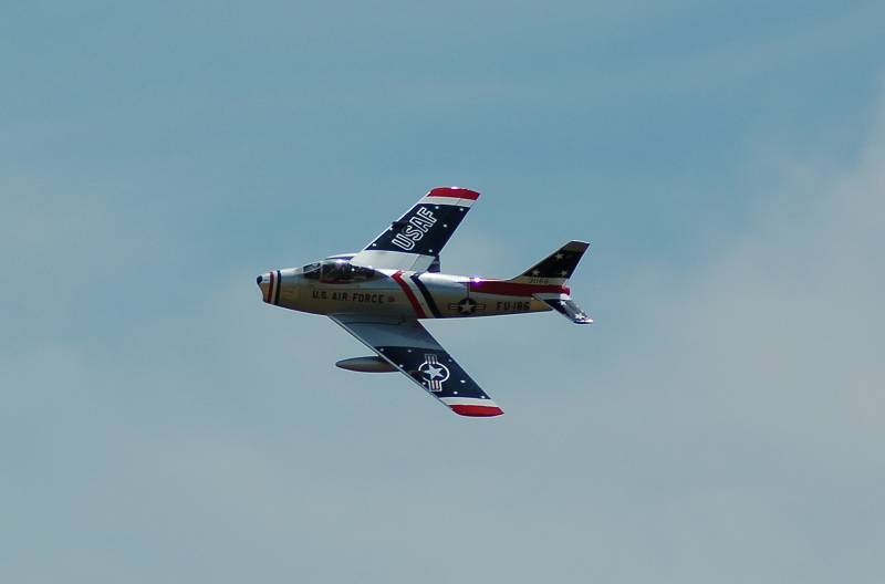

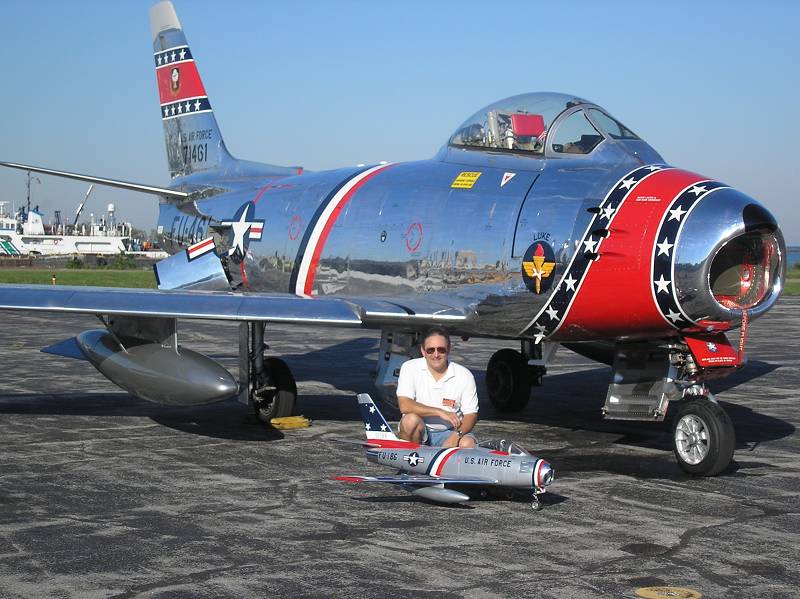

Also thanks for the welcome to turbines, I have been flying turbines for about 5 years now. This is my first step into a BVM product.
Here is a pic of My HP Jets F-86 with a Simjett 1200 Sp.
PS Mines The small one LOL

Joe,
That's a great looking Sabre!
The major difference between the Maverick and the Agressor fuselages was the fiberglass layup schedule. As I recall, the fuselages came from the same mold....BVM has more than one set, but they are the same until time for the layup. More carbon is used in the Agressor and Viper.
The same fuselage mold took care of the Maverick, Maverick Pro, Agressor and the Viper....the wings were design specific, and featured different planforms and areas.
A Wren should be a good powerplant for it, but as you can tell, I'm just a little partial to JetCat.
Another good power system would be the BVM EVF system....the latest highest attained speed for the Electra is 211 MPH....that is really scooting for an electric.
