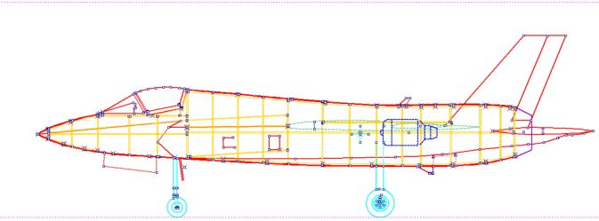

i have designed a x-35 with a cad program - metrically, 1:6
length - 2.580 m
turbine - jetcat 120
now I begin with build
rceris
thanks for this information!
length - 2.580 m
rceris

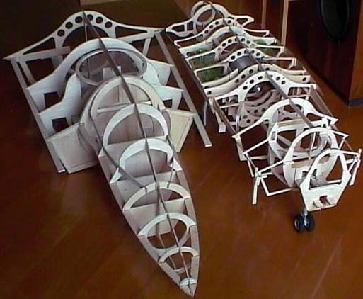

The first one that I built was somewhat this size (8'10") to be powered by AMT450. Test flying an unproven design with 45lbs thrust turbine is no kidding. So I decided to do a smaller turbine version (5'6") to be powered by MW54 based turbine. Here is a picture of the two (shows the fore fuse only of the 8'10" because I intended to do 2 parts for easy transportation).
Your drawing looks nice. Is it drawn in 3D? Take more picts and keep us updated on the progress. Look luck and all the best to you.
Cheers. Aldous.

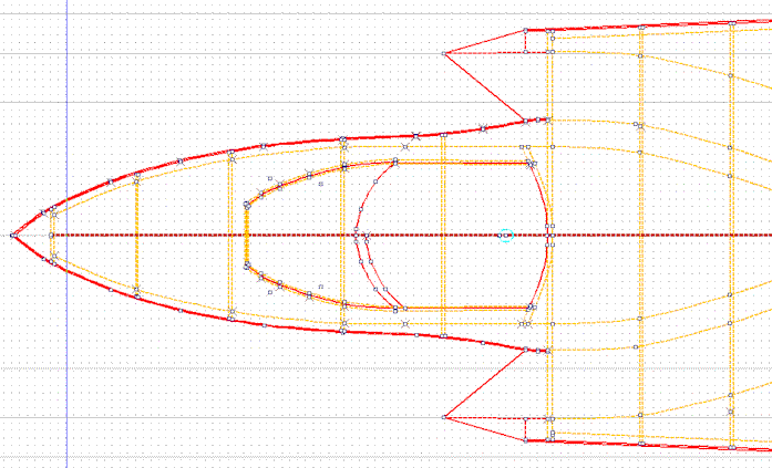

hi aldous
this flat is designed with a 2d cad program I took a picture from the lockheed website, this increased and designed the top and site view.
the bulkheads are a problem! I bought in addition a model of the revell company 1/7.
perhaps you can help me there, with a few cross sections?
thanks
rceris
thanks
rceris

Although not impossible, building a model from 2D top/side/front views requires lots of trail and error to produce correct contour for smooth surface.
I hired a CAD operator (and also learning hard myself) to draw the X35 in 3D, which allows us to amend and 'loft' the surface for preview. Also, I need my friend in States (now running Oakdaleaircraft.com to market the X35), a 3D model expert to get all things done.
I know Oakdaleaircraft will produce a CAD print plan with formers which should help your construction.
Cheers. Aldous.
Cheers. Aldous.

it is of advantage, if you can use a 3d cad program.
so you can design flowing transitions.
which uses you?
by top- and site-view i has the important reference-scores.
in addition, from this i design the frames, somewhat more complicated, but it will go!
i will manufacture these first with thick cardboard and on a railing set.
if everything is correct, I transfer these on the wood.
cheers
rceris

The outline of your drawing looks OK, but I have difficulties to judge whether the contour is correct or not from a 2D top view drawing. Correct contour is the key to make smooth surface. Do the have the formers drawings?
Cheers. Aldous..
