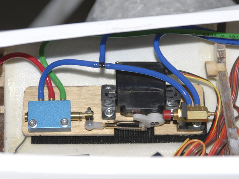

Eddie,
Here is the retract and valve on the same servo set.
