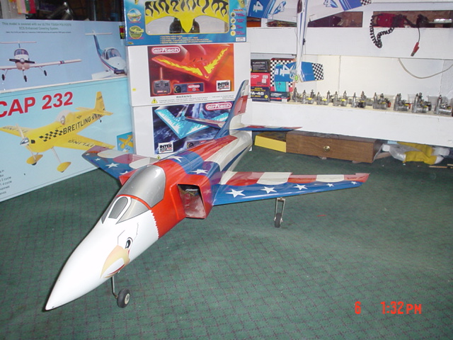

Posts: 67
From: inverness, FL
Is this a Tom Cook Starfire..was told it is. How much is it worth with JR servo s,L501,L4001 ?How much are they worth and there Torque? motor is a o.s. 77 bored out to a? .. Need help to guess how big motor could be? a 90?
Thanks Guys!
Thanks Guys!
that is an old Starfire I. I have never heard of a "bored out" 77. It is priobably just an OS 77. the 91 wasn't around when that plane was kitted.
Mickey
Mickey
My Feedback: (48)
That is a Tom Cook Starfire I. Square inlets. This model was my first Jet. I flew it on an OS 77 then changed to OS 91. I would plan on putting in a OS 91 is you can find one. What kind of gear are those. Do they retract? I would figure the airplane is worth 500-1000 if it has no major problems. That plane is probably very old. This kit hasnt been sold for a long time. Its a great airplane. Loved mine.
