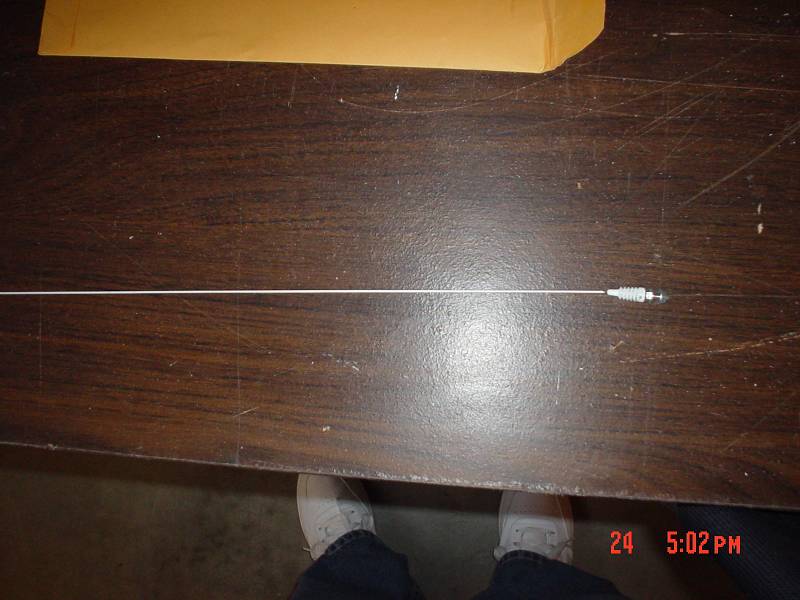

can someone tell me what make antenna this is. It was used with a JR NER-549X FM receiver. I want to know if it can be used with a Futaba receiver.

Looks like Tams to me. From what I understand it doesnt make a difference what radio it is used for as long as the length is cut to and applied to the antenna so that the length is the same.

It looks like the ones I get from Dreamworks.
Just cut the same amount from the RX antenna and solder on a fitting. Works with any RX. I have used it on Futaba and Weatronic.

Hey Guys,
Thanks alot for the information. I will cut my futaba wire and use it with this antenna. I like it and was hoping I would be able to use it. Thanks again.
