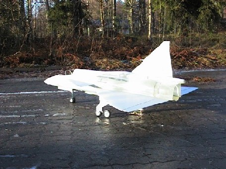

Per Strommen,
I'm building a Viggen from scratch. It's a little smaller than 1/10 scale at 56" (142 cm) long. I plan on using a Wren MW54 to power it.
Are you using separate ailerons and elevators? I've seen pictures where they seem to work in unison as elevons. The inner portion looks like it works separately when the canards are deflected. I believe that the canards are only used as flaps in that they only deflect down. And lastly, how does in fly?
Thank you in advance,
John
John
John,
The full-size Viggen was designed with a two-part elevon for possible separate elevator and aileron. After initial test flying the two part were bolted together, and Viggen has since flown with one elevon on each side. If you look closely at good pictures, you can see the joint in the elevon.
The canards are used as flaps for takeoff and landing only. They contribute to the STOL properties of the fighter.
The model flies very well if kept light. High AOA approaches look extremely nice if you have the guts to really slow it down. They require a fair amount of thrust.
Orientation is sometime a problem because the fin has the same shape as the wing, and the camouflage does not help either. Do not let it go too far away.
My 1/10th flew very well on a Ramtec with OS .91 and an empty weight of 5.2 kg (11,5 lbs), and the 1/9th is a rocket with the P-120, weight dry is 8,6 kg (19 lbs).
Tjena, Thomas
Per
Tjena, Thomas
Per

Cactus Flyer,
I used elevons and my new model likewise. It would have been difficult to get thin enough servos in a good position to drive outboard ailerons.
I would say that your elevator to flap mixing ratio is a good starting point.
BTW, if you have a slow function, use it on the canard flaps. They also work as elevators quite well. In fact, for particularly short runways I mixed down flap with up elevator in take off mode. This was as well as some flap set in this mode anyway. It would rotate the model at a ridiculously low speed. The Viggen properly set up would not stall in this condition, just rock its wings a little.
