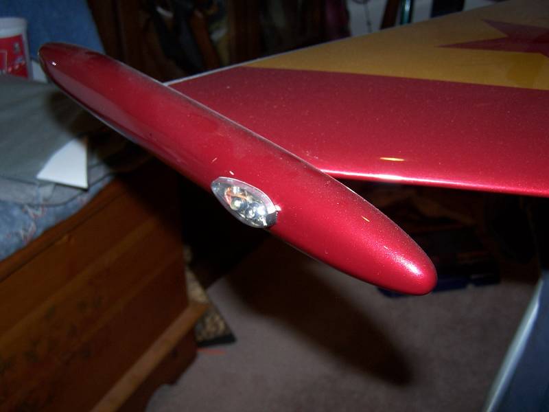

I added wingtip position lights and strobes to a Eurosport after maiden flights.I used a piece of tig welding rod to pull wires through the wing.I was able to cut holes without messing up paint,wintip lights overlap edge of hole.
Joe

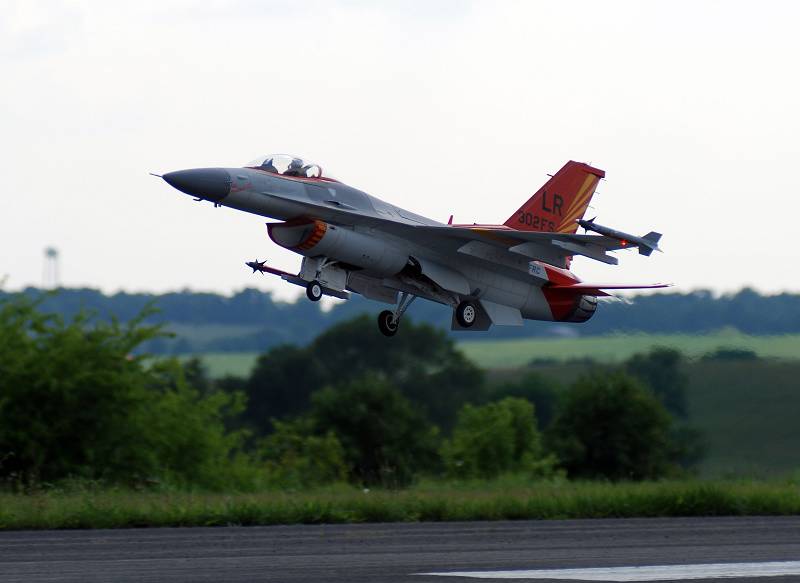

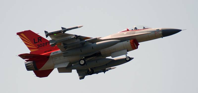

Here's a couple pics of Bryce Watson's F-16 SkyMaster. You can see his wingtip, side fuse & and top strobe lites functioning.
David S
