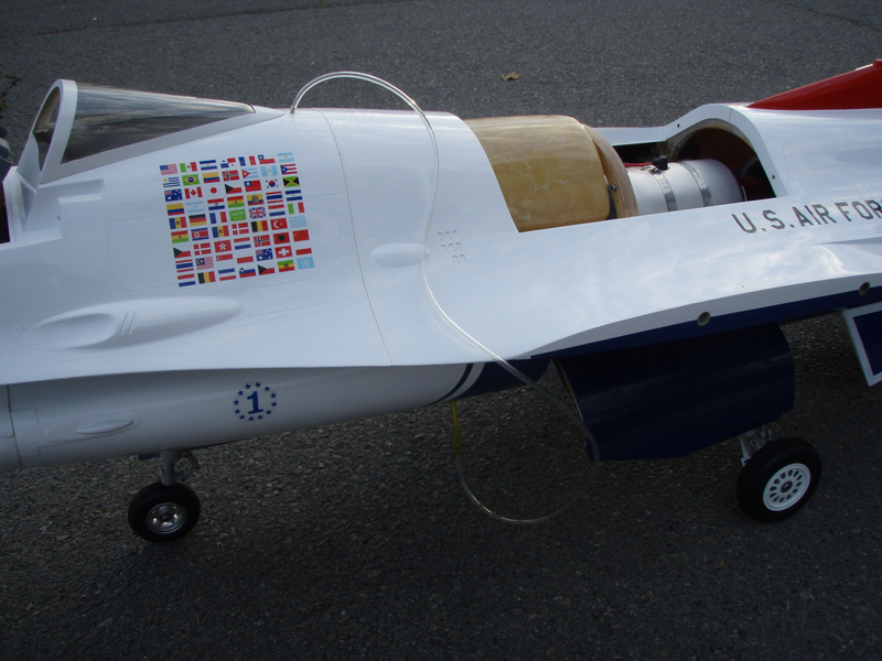

You guys may think that I am silly or something but I thought this was a good idea. I created a simple little device to remind me to put my antenna on the jet and remove the overflow plug at the same time before taking off down the runway. It's simple. Simply a smaller tube (to fit over the antenna threads) inside a larger tube (to go over the overflow fitting) with a steel block in between to keep the fuel from getting to your antenna threads. It's obtrusive enough to remind anyone to remove it before flight.

two separate items to remove and replace. Also, you have to attach it to something. Still like my idea better. Plus I'll take the $7.50 and buy myself some cold beer.

Just be sure to remove the over flow tube before gas'n up! It gets ugly if you don't.
How long will your engine run with the vent plugged. Not long.

or incorporate the two so you see the red flag flying in the wind if your taxing out. lol

The problem I had was I flew one in one time and had to make an adjustment on the landing gear after it was basically full. I had to turn the jet upside down to work on them and plugged it. In my haste I forgot to take that plug off. I think that is what caused a crash because the jet basically just fell out of the sky nose down for no reason. When I looked at the debrey I found the belly with the plug still in it.
After that I have been really cautious about making that mistake again. Maybe I'm being too cautious but this method seems to stand out. The flags are a nice touch. I was just putting something together that I already had on hand.

Long enough to get off the ground. Trust me, I know from experience. Very Ugly result.

I like it. Sweet and simple, as most of the very best ideas are !!

The KISS principle at work! Love it! "KEEP IT SIMPLE STUPID!"
