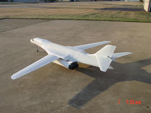

10 ft wing span, wing area 2200 in
Weight empty 20 lbs 2 oz or 322 oz
Total weight 598 oz or 37.37 lbs
Wing load 39 oz/sqft
Power systems:
hw-730 fan Aveox 36/38/3 motor
32 cell RC-3000 NiMH pack
jeti-hacker master 77-3p ESC
Performance:
Each motor 40A 30V 1200W input
Static thrust 5lb 5oz or 85 oz
Intake area 14 in
Fan Sweep Area 10.15 in
Exhaust area 10.24 in
Total power out 4000w 107 w/lb
Total thrust 340 oz thrust/weight .57
10 channel Jr10 radio
Swing wing
Full moving elevons
Retracts
Speed brake and BVM wheel brakes
Flaps
Flaperons
Rudder/nose wheel
Throttle
http://homepage.mac.com/dbbond/B1Anna/PhotoAlbum30.html
Jim

that thing is like a big huge stork, great jet, very impressive especially the brake system
