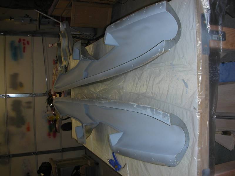

I am mixing 4 to 1 like the instructions call for and my primer coats are extremely dry, possibly too much air, mix ratio, not sure. Can I add reducer or straight laq thinner to it to get a more wet spray of the primer?
And if so, do I need to change the 4 to 1 ratio?

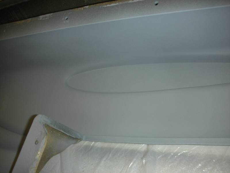

The application I most use K38 for is primer in the mold before layup. I like it cause it fills the weave really well. But spraying it with 1.8 tip is so dry today that I thought I might just ask. I've used probably two gallons of the stuff over the past 3 years or so. I have a quart of k36 here, but I have never opened it.
Next layup I will give it a shot and see the difference.
