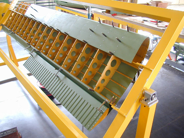

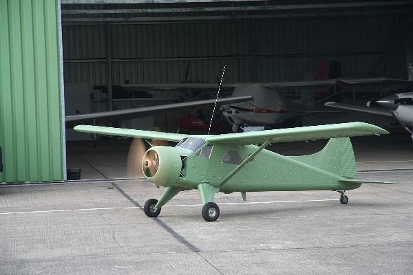

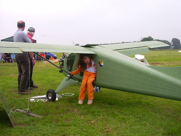

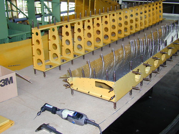

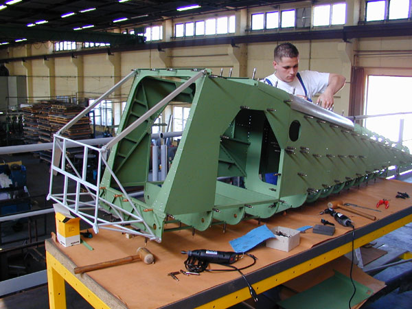

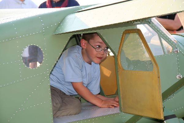

Default RE: All Metal Jet
Or this full alu Beaver......but 180lbs or 82kg
Moki/RCS 400 motor
http://www.mhm-scale-aircraft.com/
Video
http://www.youtube.com/watch?v=JwBgSMLHge0
Will never work for our small jets

The innards of that Beaver are awesome ! (As it were, so to speak, to coin a phrase ![X(] )
Seems a pity that such beatiful work gets covered up with such a bland exterior.
