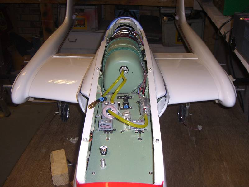

Yes, I have the new plastic valves with the black barbed fittings!!!! They look really cheap, dont they? You can just make them out in this picture.
I am in Runcorn, and fly down at Frodsham, Just off M56, in fact you can see our field from the M/way.
