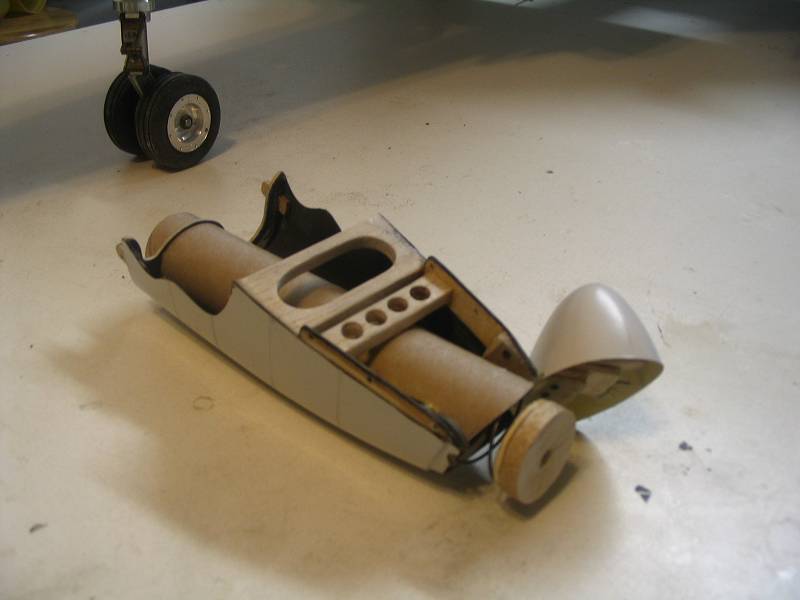

DavidR, Those wheel collers and grub screws may seem crude as restrictors but once set up they sure are reliable. My Aggressor only gets about three flights a year but the retracts are always flawless.

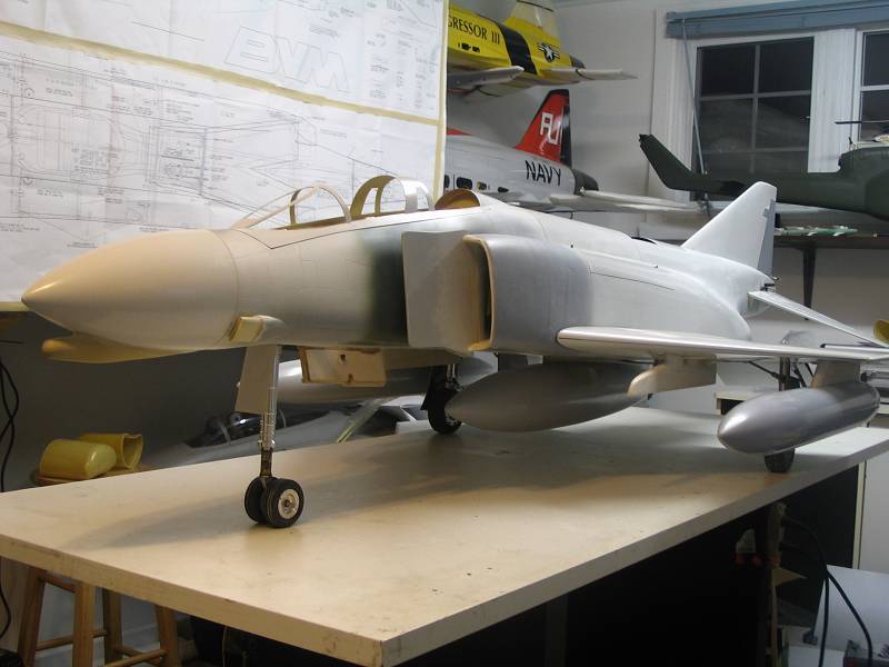

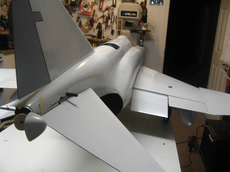

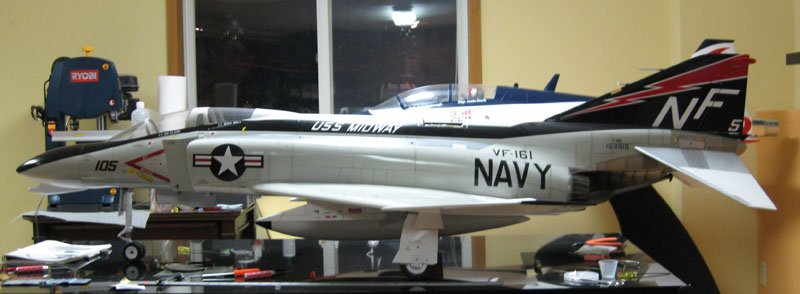

Here's where I'm at:
Patrick, What size Dan Gill chute do you use? 14 or 16 inch?
David G, The slotted stab is that cut into or added on to the leading edge? Mine will be a AF C model, perhaps without? I have not got any documentation yet and have still not settled on the subject yet.
My Feedback: (40)
ORIGINAL: christrump
Also the CG itself I see has been moved to 12 3/4. Is this optimum or can it be moved further back?
12 3/4 is optimum and should not be difficult to achieve with batteries (or a little extra lead) in the nose. Oddly, this is one airplane that does not fly as well with even a slightly forward CG. I suppose you could experiment with moving it aft a little, but I would suggest going with what is proven.
Just a reminder, the 12 3/4 is along the leading edge, not straight back along the wing root.

It looks like you have done an excellent job on your phantom. I just finished re-plumbing mine with two high flow BVM valves and the jet-tronic gear sequencer from Jet Cat USA. BVM rep Ad Clark came up with the idea and it works great. What paint scheme are you going to do?

I started off with a showtime 100 scheme then I dont know what happened but now I'm into an AF cammo scheme...that could all change though!
I did commit to the nose fairing (showtime 100 has none) and sprayed some green paint before adding the diverters.... wont keep me from going Navy....??

The Chutes are approximately 20" in diameter and you can purchase them from Dan Gill (Details4Scale), Justin Sands or Phil Nuza. I have bought chutes from all three guys and all are nice!
Where did you get your chute spring?
Also................if you are interested in the extendable nose strut I can get you the guy's number out of New York that makes them. They are sweet!

Patrick, My kit is an early DF version and it came with all the parts for the chute including the spring.
