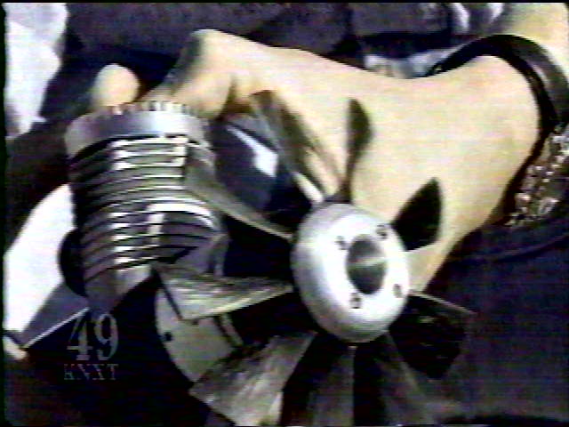

Hi,thank's Terry for jumping in here.I have not yet put A OS carb on A Rossi but it is possible.Do A search on carb and Email Jackjet becouse Terry and Jack is the only one's I know that has done this.Vasek,I like the Rossi's for the way they are built on the inside.Next to the BVM (Nelson)( Dubb Jet fan 90 engines are hard to find) Rossi's are next on the list.The piston rod,ports, fit and looks.I'm trying to get the 1.00 cubic inch engines to run right,I do not have any 90 size or smaller engines.That's all I have are the larger Engines.I have run smaller engines both the OS 77 and the K&B 82 but I wanted to find out why these 1.00 ci engines where having problems.I know now that it is mainly A pipe problem,the stinger,output hole is to small making them choked up with back pressure.As to buying shims I have not bought any so far as to date.I don't need to as I use no nitro fuel.The best pipe so far I have found is the big prather pipe or cut the stinger off.Michael,George Miller kits,Is your's A Byron pusher type or Danamax.The Byron spec's are Rossi 81,5% nitro,19,600-19,750 rpm's,pipe length,11-3/8",static thrust 11-3/4 to 12-3/4 pounds.Take care-Mac

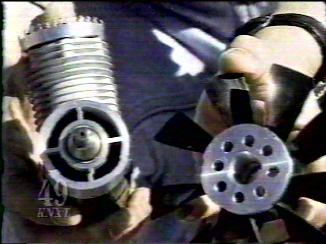

Default A OS,Rossi,OPS?
Can you guess?

Not sure on the engine in the pic Mac, but my George Miller F-8 is setup on the with the byron system. Thanks for the setup tips, how much oil do the rossi's like with the 5% nitro, I have some 5% nitro and 25% or 30% castor fuel at home,(don't ask I was going to mix it with some byron fuel for a Moki 210 I have) do you think that would work ok in the Rossi? Mac you may need to change your name to Rossi Guru

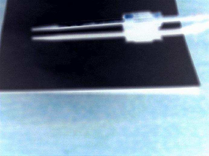

Hate to bother you again Mac, but I pulled the needle out of the engine, and it looks like it is already sharpened? Do they come from the factory with a constant diameter meaning that this one has already been modified or should I sharpen it some more, I took a picture but my cheap digital camera won't focus that well on it, I inverted the colors and you can see the point better, what I want to know is if this thing has already been modified? Also on the tuned pipe length, is that measured from the center of the glow plug to the highest point on the tuned pipe? Well thanks again
Michael

Hi Michael,That's looks like the high end needle maybe.My carb has only one needle, the high end needle is caped off for A remote needle.The one i'm taking about is the one that slides through the spray bar and when you twist the barrel to the open position it moves outward to open the little hole on the spray bar and you can see it from the back side of the carb when you take it off the engine and it is turnable with A screwdriver.If this is the needle you removed`you're ok.If you remove the jam bolt on the carb the barrel will come out and A liitle tension spring will come out also,don't lose,don't ask me why! and I have never seen one tapered so long.Let me know or disregard what I said.The pipe length is fron the plug to the fat part of the pipe.I have the instructions for the Byron F-16 and it states some pipe length info on the rossi 81,90 and the OS 77 and the 91. 11-3/4 to 12-1/4 lbs. of thrust the 81 in your jet sould be 1 to 1 ratio and it should kick butt.Talk soon-Mac

Once again thanks for the info Mac, yes I had pulled out the wrong needle, I took out and was showing you the pic of the high end needle. I'm going to rebalance that byron blade so when I take the engine out to do that I'll also check out the other needle. If I can get a 1-1 ratio with this jet I should be in for a nice suprise, I'll post picks if I ever get it in the air. Thanks again.
Michael

Regarding the photo you posted looking for takers on "guess the engine:"
It looks like screenshots from the SKS video a few years back of Wolfgang Kluhr displaying his Russian Angstrom .91's that were used in his Su-27.
Am I close?
David

Hi,David your right on the money,You get A free prize,send me your address and I will send you out something like two free Vinton O rings.John,the K&B100 on 15% nitro was still not enough nitro.I had to mill A heck of alot off the head to get it to run on no nitro.When you flip the K&B over before milling the engine had nothing but now it has about the same a the Rossi105 does and it runs right now.Take care- Mac

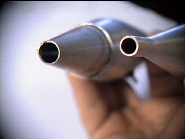

I bought a used Rossi 105, Byro fan(pusher) and was wondering a starting point on pipe length? The pipe that came with sure seems to be small. Comments?

Hi,I know that the tuned pipe for the Rossi should be black.The pipe length from the plug to the fat part of the pipe should be around 12 1/8" .That should be A good starting point.Can you post a pic of the pipe.Take care-Mac

Hi Mac
That is correct the pipe is painted black. It came setup with about a 11 3/8" pipe length. Lengthed pipe to 12"and seemed to help. Guess i will try a little longer. Pipe was getting real hot, started burning paint off! Sorry do not have a dig. camera to send a picture.
Thanks very much: Rodney

Hi Rodney,I will post A pic of the black pipe and it is made of medal not aluminum so if the pipe is the same as the pic I will help you fix your problem.The problem is not expansion but back pressure.If you would get A pipe of the same size as the output pipe and weld it to the other side of the tuned pipe so you would have two output pipes your pipe woud not become so hot becouse of back-pressure and it would make the Rossi 105 run like it is supposed to.When they started to make the larger engines they kept the same size stinger or output dimensions on the .60's size D.F. pipe and up so to me that did-not make any sense to me at all.The bigger the motor the bigger the stinger.The sound wave nocks the extra fuel mixture comming out of the engine and not the back pressure. Take care-Mac
