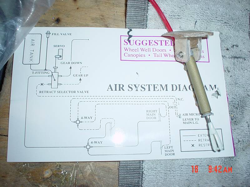

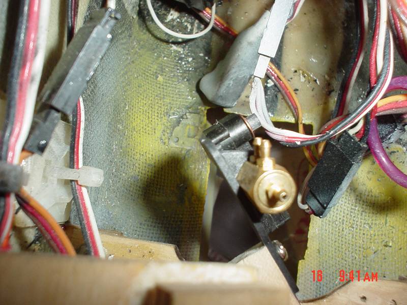

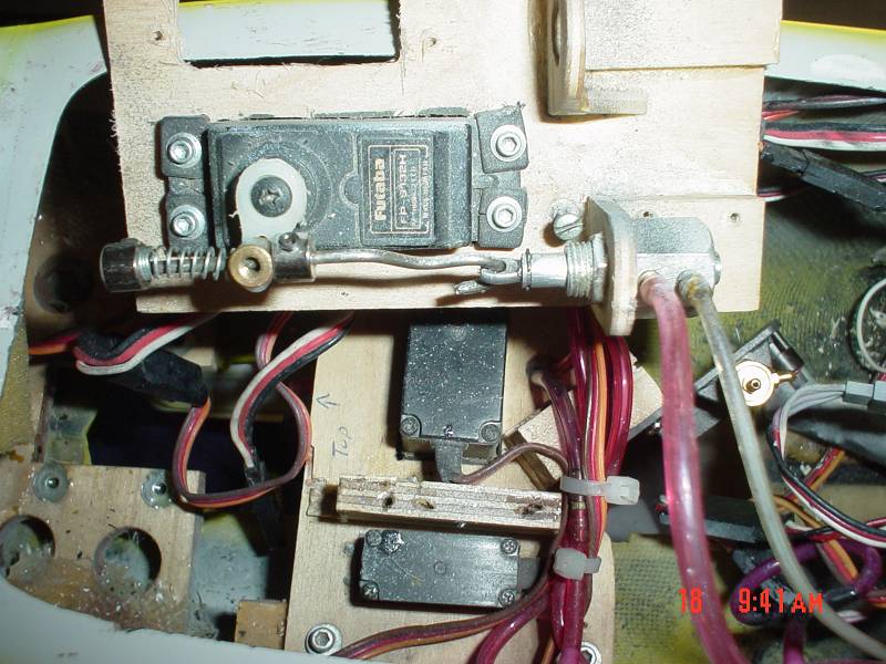

Guys, I am at a loss on how to hook up the air hoses for my door retract system. I am using a BVM micro switch and a air cylinder. My problem is how to hook up the air hoses using whats in the plane. The first pic shows my servo with the switch to opereate my brakes. The small clear line operates the brakes. It has its own tank and works fine using the down evelator but only works when the gear is down. The next pics show my micro switch which works when the nose wheel hits it . I don't have any lines hooked up yet. There is a connection for three lines, one on the top and two on the side. The next pic shows my air cylinder with two connection.
My question is how do I hook up the lines to push the door open and pull it closed. Do I need different air valves or can I use what I have. I even have instruction but they show a system for mains and nose door and I'm only using the main gear door. I know this sounds complicated or at least to me, so if you have any suggestions I would love to hear them.

I am not familiar with the type of valve you show in the pictures. I have not seen that type of valve with three nipples before. I have successfully used a similar valve from BVM. Find it here at the bottom of the page:
http://bvmjets.com/Pages/Catalog/air.htm
It looks like yours might be a BVM unit but I am at a loss to explain that 3rd air nipple. You can see that the BVM unit has a hole where your third nipple is.

All of those little button valves have three openings even the one pictured on bvm`s site. It just doesn`t have a nipple screwed into it. That opening is where the pressure releases. They work well, just have to hook up the retrac "up" side to the button and then the cylinder, it will close the door when the strut hits the button. The down side air will kick it open with the gear at the same time.

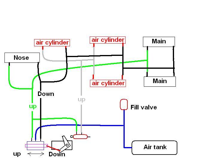

Maybe this will help.

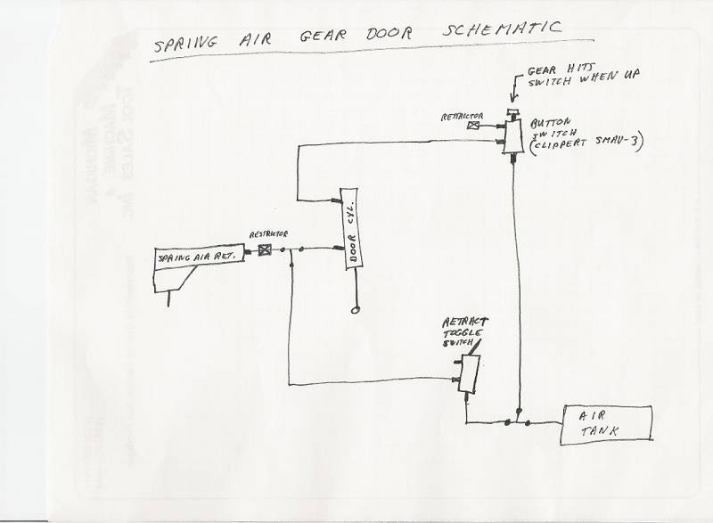

I wrestled with the same problem for my Maverick nose gear door. Since there is only one line going to the retract you have to be a little creative. After an hour or so I came up with the attached. It works fine. The restrictor on the relief side of the button valve is optional, it reduces the amount of air used each time the doors are cycled.
If you want to do this for two mains then just tee the two retracts together, and tee the two cylinders together. Put the button valve on the side that retacts the slowest. Another option is to use two button valves, one for each side but that's really not necessary.

Joeflyer, thanks for the drawing and the comments. You diagram makes sense to me and I think I can make it work. Will give it a try because at least I understand the setup. Billy, thanks for the drawing, but I don't have the type of system your diagram shows. Mine is a single line system which to me makes it more complicated.

Joeflyer, You show on the diagram that the top outlet on the side of the button switch is restricted. Is this a correct assumption.

Yes. When the strut hits the button air pressure in the line from the upper cylinder nipple is vented to atmosphere through that outlet. Putting a restrictor there slows it down so that the gear door doesn't slam shut.
