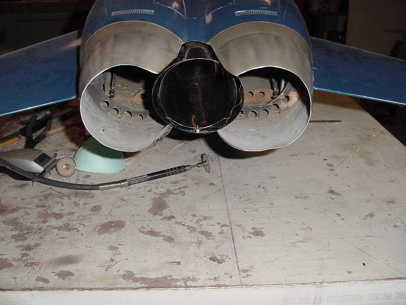

Even Gary Baker made one.
Who is he????
And I was able to get 29# of thrust out of my Titan after I got the thrust augmenting pipe fine tuned (The Titan only put out 26.5# on the stand without the pipe).[:@]
I just built another one for my YA F-18. Can't wait to see how the Merlin pushes the big bug around!

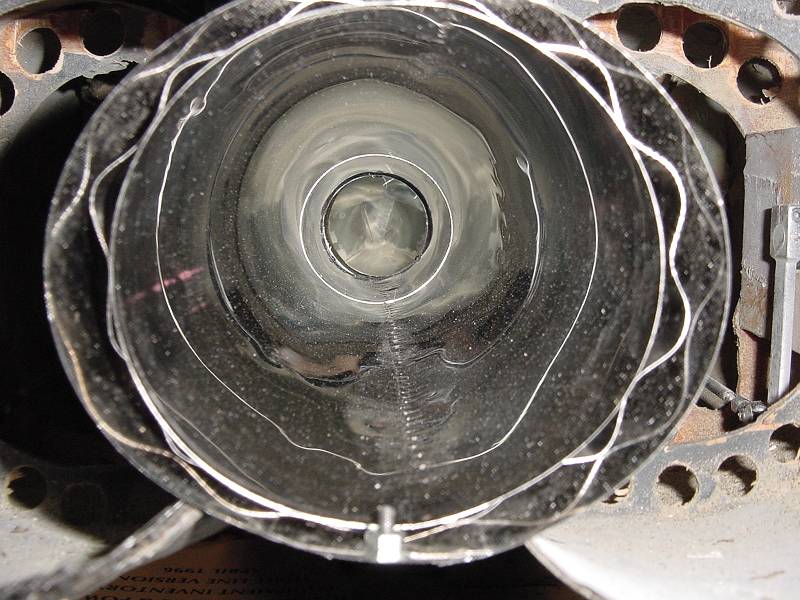

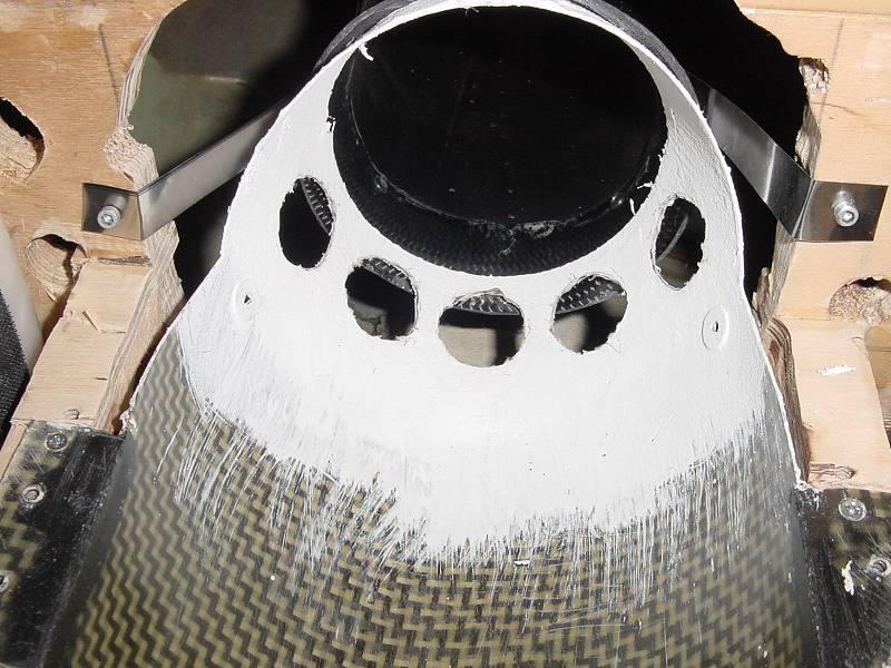

You made a bifurcated pipe for the bug?
No, it's another straight pipe. I'm not brave enough to make a bifurcated pipe yet.

Gary,
Maybe its just the pic but that former the pipe is secured to looks like its 1/2" plywood !!
It is!! Two 1/4" ply laminated together. What you can't see in the pic is that there is another 3/8" ply laminated on there also. I didn't build thus one, I just refurbished it.
