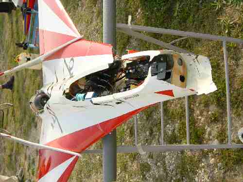

both roo and hotty are easy to fly and land.
once on our hotty we had the CG a little too far backwards resulting in a reverse flat spin (because we experimented with spins, we never did it again
this caused the loss of the nose
otherwise wonderful to fly
