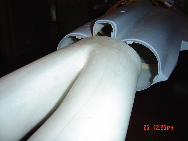

I know you ordered this also when I talked to you at Fentress. I got mine in but how in the world do you get the bifurcated section into the jet? It is way bigger than the turbine exhaust pipe. I am sure not going to cut the airplane. It looks like the ducting has to be installed during production.

I actually haven't gotten my Rafael yet. It should be here in a week or so and I'll take a look. If it won't slide right in, then I guess we'll have to figure out how to section it and then re-assemble inside the airplane. Maybe two sections, fore and aft, like the ducting for the JHH A-7?

Sounds good. It already comes in 2 sections, the bifurcated rear section is the problem. It will take some creativity to get in there. I will hold up on mine until I hear back from you on yours. Hope all is well.

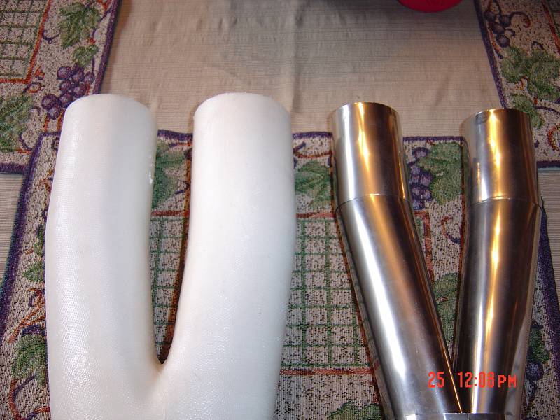

Would it not install the same way as the stainless steel pipe? You install it from the back of the jet, with the rear center piece off it all slid in very easily, I would think a fiberglass bifurcated pipe for an EDF should be able to be squeezed much further than the stainless one to insert it? Just guessing as mine is the turbine version, but that's how the pipe goes in on it, through the back end.

The EDF pipe at the start of the bifurcation is bigger than the turbine pipe and bigger than the exhaust nozzles on the kit itself. You would have to cut a hatch out of the bottom of the airplane. I tried it in my FEJ F-15 and it would work great!!! I dont think 12 -14 pounds of thrust will fly it though!!! I may have to put a P60 SE in the Rafale. I will let Bob make the decision for me on this one when he tries his.

I have been bamboozled!!!! Just joking. This is a nice bifurcated pipe, but heavy. It will not hardly budge when I try to squeeze it. The weight will definitely help to offset the batteries up front. I got faith in you Bob to figure this one out. Enjoy your trip and drive safely!!!!

For the JHH A-7, I split the second duct section (the one right aft of the fan) down the middle (along the longitudinal axis) so that I could roll it tight and get it to slip inside the aft section. Then you slide if forward and screw it to the fan. There is a poly-ply "lip" that you then screw in to seal the split and make the duct rigid. Something like that should work for the Rafale...

I've orderd one of these which should arrive today. I plan to ditch the edf ducting and use a single straight duct and modify the rear end to suit. Sort of like the Comp arf Euro. I know it wont be scale but I think the efficiency gain with a single pipe will be worthwhile. Also weight saving from what you said about the layup of the stock pipe.
Is there anything on the inlet side or are not ducts supplied here? What is your impression of the weight of the model?

Nothing on the inlet side. These kits are super nice!! They are a tad heavy, but they were designed for turbines. I will probably use an inlet ring on the fan, not ideal but it works. I know of somebody who will probably design some intake ducts. Your idea of a straight pipe like the Euro will definitely work well and be an easy modification. Keep us up to date on your progress.
