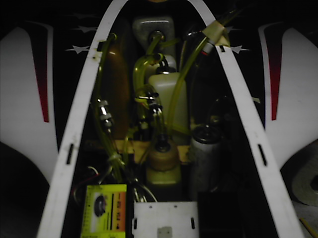

I agree 100% with Mr: Thud D, I have also rebuild a few. We have a Kingcat that is about 6 to 7 years old and so was the UAT, it was leaking through the cap and nothing could fix it, so we change it.
The plastic bottles have a certian amount of life ( cycles ) and when they get to it they have to go, they are about $ 1.50 a piece.

"Apply a wrap of safety wire to the 6mm tubing on the brass fittings. Periodically check that the plastic cap is hand tight on the bottle neck."
The photograph on the front face of the instruction sheet also shows that the threaded bottle neck comes with a teflon tape wrap to help seal the bottle. Quote; "This shows the proper orientation of the sack in the tank. It is best not to open the tank unnecessarily so as not to disturb this setting. Note the teflon seal on the bottle cap threads."
If you mount the UAT in the position indicated on the instruction sheet, visible in your installation, and at the suggested 20 degree angle with the brass fittings up, it should not be much of a problem for you to occasionally check the cap for tightness, like at the first flight of the day) and the UAT for security of mounting.

I had a UAT leak from the aluminum fitting inside the center cap, only after refueling and only after the nose of the aircraft elevated over 20 degrees. My first occult UAT leak in over 30 UAT's I've owned.
I found this after 2 consecutive flame outs. This ultimately cost me my airplane. [:@]
Harley, I helped a local guy install his brand new UAT that he got from Tam and the instructions actually said it was ok to mount it vertically??? [X(]
I know many, MANY people have had success with a vertically mounted UAT, but the instructions CLEARLY stated the slant in the UAT was the preferable method.

In the KingCat, the UAT is mounted vertically, and secured by a laser cut plywood mounting plate.
The UAT seems to be fairly tolerant of the mounting angle. When they were first produced, I retrofitted my Classic Bandit with one but had to mount it horizontally (brass fittings at the top), and it worked just as advertised for many flights.
Just be sure to keep the cap tight!
