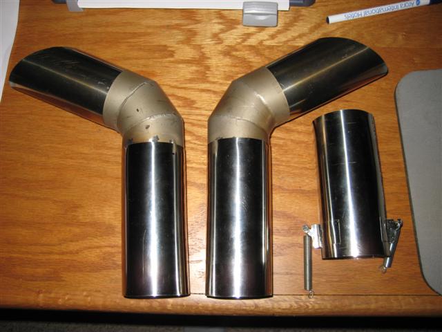

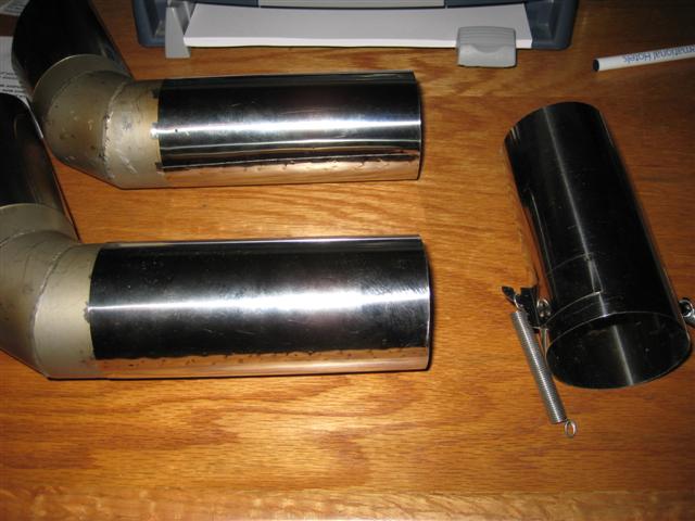

I built a few with a homemade spot welder. Here are a couple of examples for a friend's turboprop and a long one for a scratchbuilt project.
I used .007 stainless sheet. It's cheap and easy to do. Best of luck.

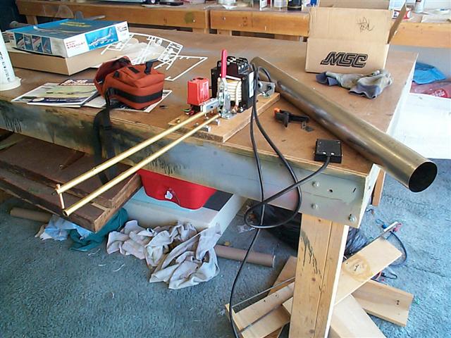

The normal stainless shim stock was just too small on the width for what I wanted, so I bought a sheet of .007 stainless, 24" x 10 feet long.
I don't think it's really worth all the hassel building a spotwelder from scratch, unless you just like puttering with this sort of thing, so I bought one.
