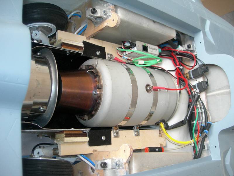

Glad to here you cleared up the weight issue, Tam's F18 weight is 34 lbs dry and with the size difference it has to weigh more. I hope there is a cross brace on the main wing former or its going to be a smoking hole.

Kelly,
Looks like they have provision for a cross brace just like the Tam F-18F. Same place as well. See the photo.
David S
