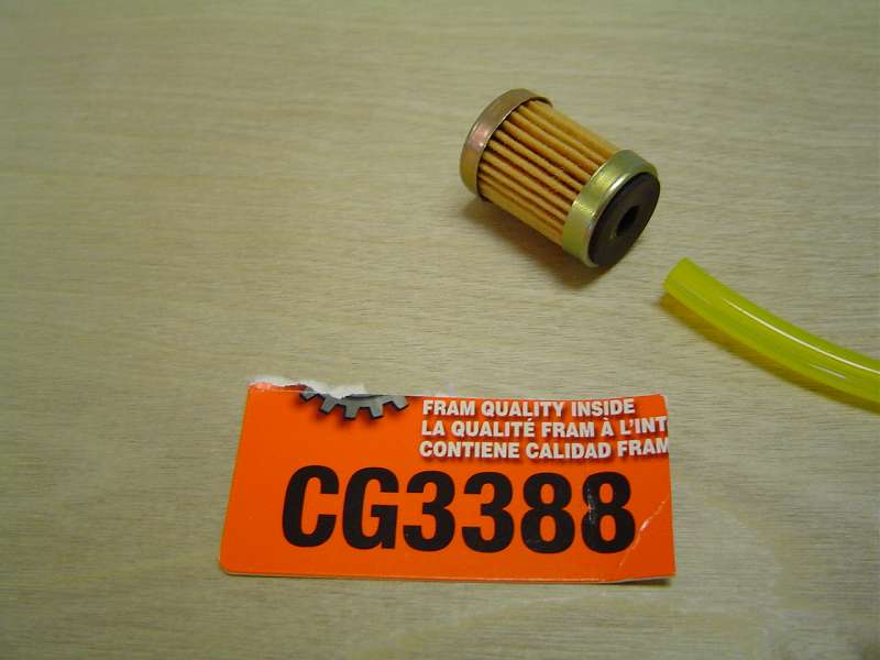

John
Try
http://www.rockauto.com/dbphp/prt,915,CG3388
For purchasing filters Fram CG3388
Also see
http://www.tecnopar.com/download/catalogo.pdf
For a list on page 13 of the various manufacturers equivalent parts
Very simple to make, you need to pull the rubber insert out and heat the end caps up so they can be removed. Ideally with a lathe make up a brass dome end and a brass washer fitted on a brass tube with cross drilled holes in it. Epoxy the ends on. I have made 12 or more now.
I have never used a UAT in any of my planes the pleated paper will draw fuel before it draws air and it will empty the tank to almost nothing. The weight of the UAT in small planes can affect performance and justify not having one. If you have a large plane with plenty of room fit one if it makes you fell happier.
Hope that helps
John

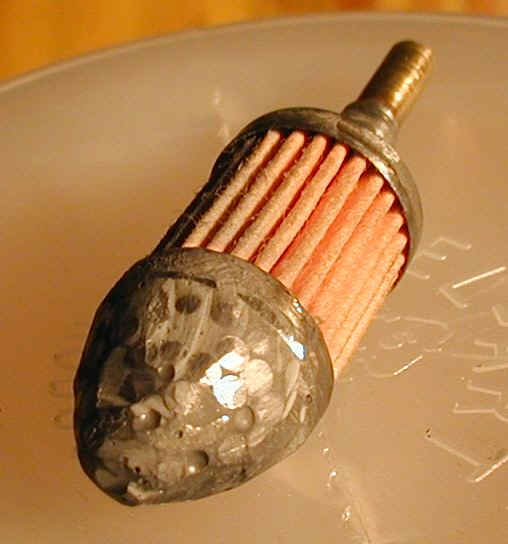

Thanks very much John, could you post a picture of an assembled unit please?

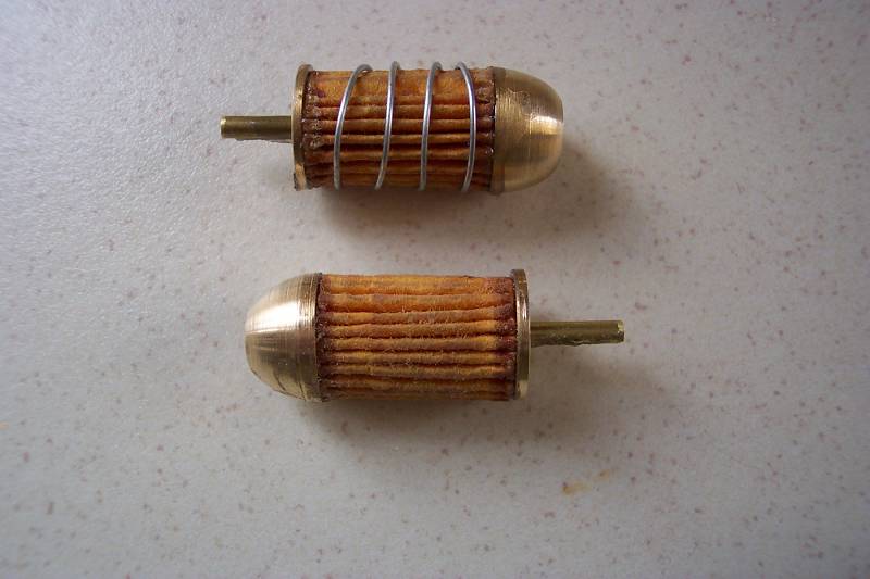

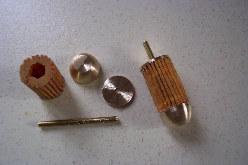

John
This is a few pictures that should help you. Let me know if you need more help. I used the thickest Araldite epoxy to avoid it wicking into the paper.
John

Thanks so much for the Pics, John. You use about a 1/8th inch inner tube, and Tygan to run to the bottle stopper? Looks about the same size as the Wren type felt clunk, and you certainly can't beat the price!

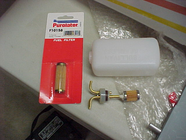

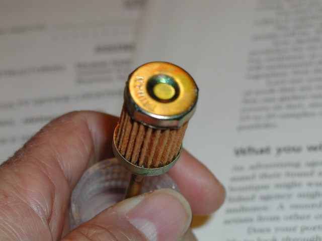

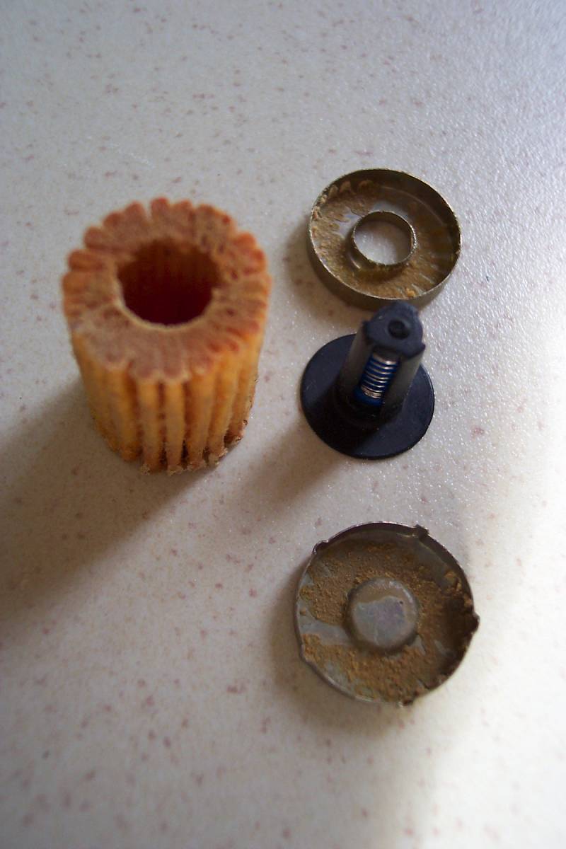

Here is a simpler way for a home made UAT or clunk.

Yes The brass tube I used was 1/8 inch and I connected to Tygon. I have used both Sullivan and Dubro tanks. I am able to make sure that the cluck will fit in the tank opening, but if the end caps are left on it is a tight squeeze.

Here's more. You can actually make the entire assembly using JB Weld. The larger pleated paper filter will offer less resistance to fuel flow. >
( And yer better not call it a UAT if it's homemade and not from BVM, or BV's gonna sue yo butt. )
