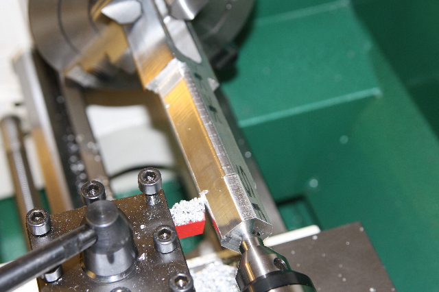

The mill is this one:
[link]http://www.grizzley.com/products/6-x-21-Mill-Drill/G0619[/link]
And the lathe is this one:
[link]http://www.grizzley.com/products/10-x-22-Bench-Top-Metal-Lathe/G0602[/link]
My goal was to try to find one for 1k each, and came pretty close to that. They have went up by about $100 each since I got mine.
I did a ton of research, and settled on these. I'm pleased with the quality and can get down to about a half of a thousand'th tolerances. The lathe I wanted to have 1 inch through the headstock capability. The computer readout of RPM and digital depth gauge on the mill are very nice too. I know CNC is the big buzword, but doing things manually has turned out to be not tough at all. It's not like I'm making a ton of any one part. Considering I'm making 1 or 2 of about anything, I probably get it done just as fast, by skipping the PC part. I can retrofit the mill with CNC later, and may do that, but figured learning things manually would be wise, and I'm glad I've went that path.
The lathe was what I first started thinking about, but now, realize probably 60%+ of the time is spent at the mill, and am glad I went a bit bigger on the mill, that I had originally planned.
Plan on spending about another 1k on 'extra stuff', from vises, to rotary table, to end mills, lathe bits, measuring tools, etc.
I was heasitant to take this leap, but now after the fact, I'm very glad I did. It's such a great option, if I need a bit of something, to just walk over and make it, down to a thousand'th of an inch, and keep rolling.

I'll put in my part here: Lance is a natural with this, it's not as easy as it looks, but you can do it. You can go to local community college also (a good start) and buy some books. Here are some tips;
My advice to Lance was to stay away from a "3 in 1" machine. Spend a couple of extra bucks and get a separate lathe and Mill. You will learn that the savings in setup times and ease is worth the money.
Unless you get a very small (i.e., Taig) they are going to come truck freight. Get a lift gate, the driver will have a pallet jack to move it into the garage, etc.
Unless you get a full size machine, you should be able to lift them with a chain hoist over a ceiling rafter with support on the sides, or hand lift them with some help. A full size machine is going to weigh a ton or more. If you do that you are going to have to have a fork lift on site to lift the machine from the truck.
An option for a small bench top Milling machine is a 55 gallon drum with a 1/2" steel plate on the top for a stand, a small lathe isn't as heavy, but if you have the option, buy the stands - save some time / money here. If you can weld, and have a welder (and are proficient with it) you can make a stand.
Digital readouts on the Mill are awesome, but you can set it up with dial indicators and be just as good (read below).
A general rule of thumb is (from experience): If you pay $1000.00 for the machine, expect to pay $1000.00 for additional tooling (cutters, measuring tools, etc.), that is what we do, it has never been wrong, regardless of the cost of the machine. If you are a regular machine shop, this may not apply fully, but you can almost see the tooling add up to the cost of the machine in most cases is you are starting out. You have to be a machinist before you can use a CNC machine, so forget that route unless you are at that level.

That 'mill' in the close-up pic of making multiple reinforcing wheel struts looks really small - is that some sort of attachment for the main Mill? Or something special you have made?
Either way, a Mill *and* a Lathe for around a grand a pop is darn good shopping mate. I doub't if I can get anything close to that down here in Australia. Most things I have priced so far run around 2 1/2 thousand each. Overseas stuff can start out a reasonable price, but the shipping is the big killer.
