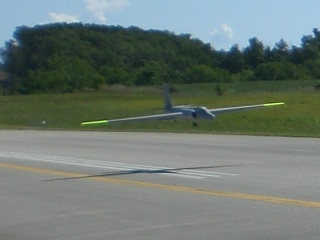

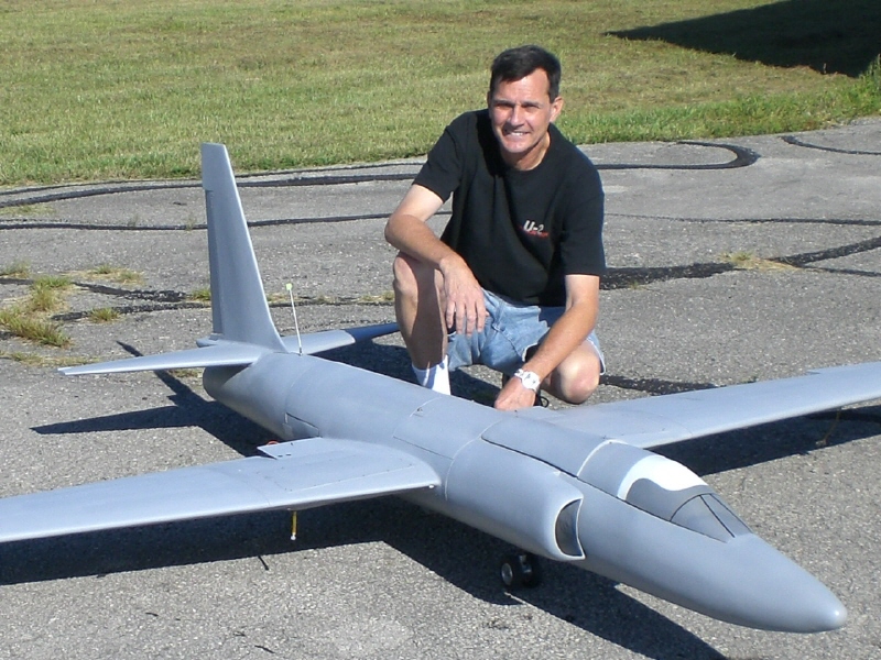

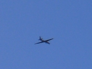

My 1/6 Scale Scratch Built U-2A (the early one) continues to fly well.
Specs:
U-2A
Span: 160"
Length: 96"
Height: 30"
Weight: 50lb
Fuel carried: 1-gallon (2-56oz kevlar tanks in the wing roots, 16oz header tank+ UAT).
Powerplant: JetCat P-80
Conventional construction (white foam,balsa, F/G and carbon fiber)
2-plug-in 5' wings.
