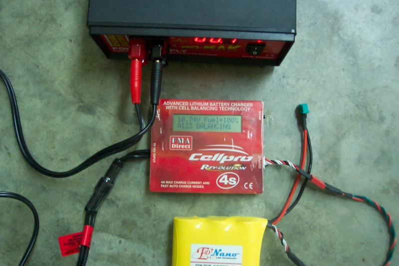

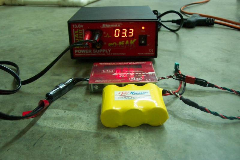

I can't speak for the FUTABA R6014FS in regards to using A123's, but I can tell you the Spektrum AR9000 has no problem in handling them. Also no problem's using the A123 3 cell on the Jetcat ECU...to date anyway!
Had to lengthen the charge/balance lead on the ECU pack...so snapped these pics before I installed it back in the aircraft.

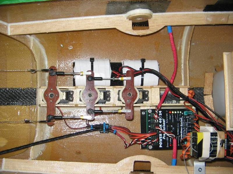

I am also using the A123 for my receiver and love them. And I see what voltage they can keep when discharging under load. I would never use them without a regulator. Have Futaba said you can use 5 cell nicd or nimh? Most of our equipment is ment to operate on 4,8 to 6 V, that means yon need an regulator. If you will have som margins on your side an fly safe use a reguator. Don't push you receiver/swithes/servoes limits just because some is using this combination without problems. [sm=drowning.gif]
For example in F3B -competition gliders almost everyone is nowadays using a 5 cell Ni -chemistry pack - never seen one or used one with regulator. And yes, they take considerable amps during winch towing. Guys - me included - regularly use 2S LiFe -packs without regs in large gas planes too - amp draw is considerably higher in these compared to our jets. For example my 40% MX2 takes around 700-800mAh per one 8-10min flight. Over 100 flights this year with A123s, no regs neither problems...
Of course servo life could/would be shortend with higher voltage and thus higher speed/amps.
For high quality switches or JR/Futaba receivers even 8V is really no problem in my personal experience. Never blown one or seen someone else have problems with these components due to 'over' voltage.
...my 2 euro cents...and sorry for some offtopic comparisons and pics - this is after all the jet forum...
