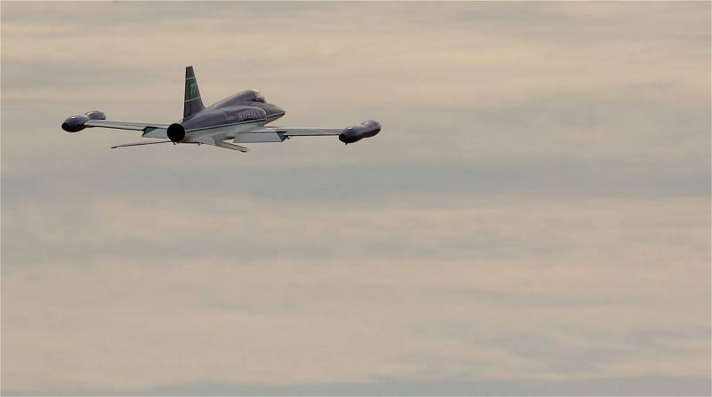

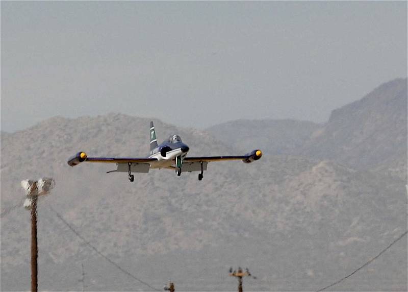

Default RE: BVM MAVERICK
mine dead sticked on me one time and the glide factor set in on a long distance pass. never had any problems with tip stall or controlability. now that doesnt mean i made the runway but it never had any bad habits at extreamly low speeds. but your rite the newer the bvm sport jets get the better they fly.
...mike

Mike
I see you have flaps on yours and they would have helped no end. Mine never had flaps and was a tippy pig on dead stick or slow landings. Good for the reactions though
jason

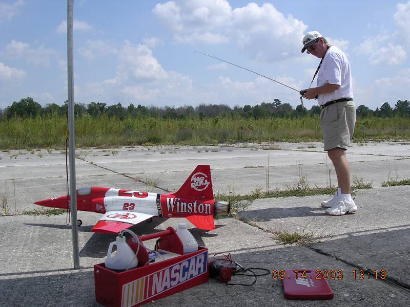

You guys dissing the Maverics and Mav Pros are SMOKING CRACK!!!! That, in my opinion was the best damn "pre turbine" plane ever built. I still have my Mav Pro and fly it still with a 91 (the 96 wore out). I too wish Bobby would re-introduce the plane or sell the molds. A friend of mine has two NIB, seems he is stock piling.
Anyway, my 5 cent worth.

take 2 for my bandit, i love that jet. i like the winston scheme on the pro looks good.
...mike

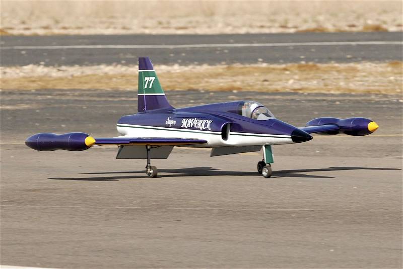

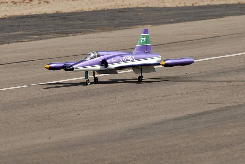

I have to agree, I love my Maverick. 165 Ducted Fan flights, and now 118 Turbine flights after it's conversion. It was a great Jet to prep for turbines and now is a great warm up Jet before flying it's faster big brother Bandit's.
I put the leading edge droops on after a huge scare on it's third flight, and that seems to have cured the snap tendency. It had stock split flaps as a DF but I changed them over to larger Bandit style flaps when I converted it, just in case I needed more drag to overcome residual thrust from the turbine.
I have given it more than it's fair share of abuse over the years and I have to say it has held up extrememly well. Tough little Jet.
Maybe BVM wasn't happy with it but I sure am!!

GSR
My Feedback: (145)
Posts: 1,970
From: Seal Beach, CA
WNTOFLY- Did you ever notice any blanking of the elevators with your flaps deployed that far? I thought I ran into that the first couple of flights so I moved them back a bit. Scott
