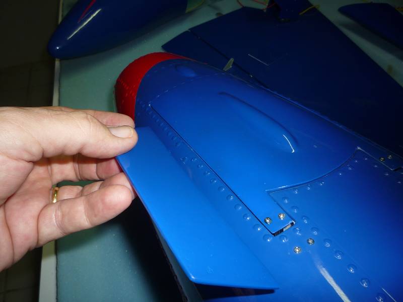

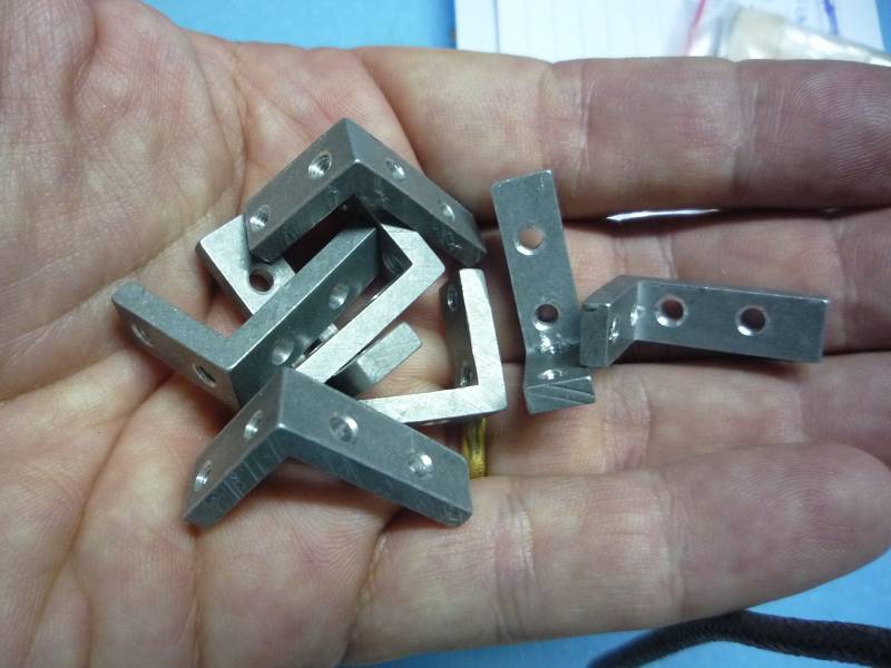

Anybody knows where to fit these parts in FB Hawk?
Whats the correct position of the tail fins?

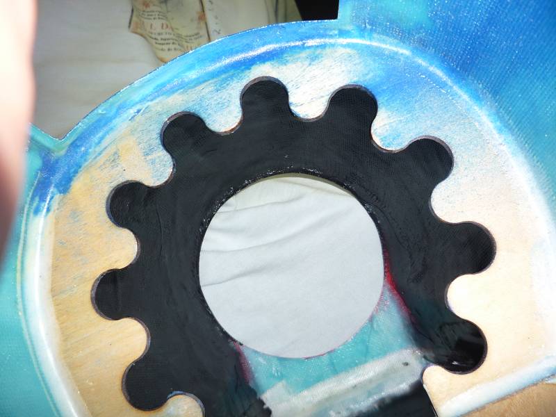

How to fix the exaust tube on end of tail?

the second pic is the servo mounts for the wings/rudder, they confused me for a while during construction of my FB F-86.
the first is shown in the line drawing below.
the third, I don't know as of yet, my hawk is undergoing minor damage repair and I don't have the pipe yet.

I used a Tams pipe and it had two tabs welded to the pipe that bolt on the back former.

For the last pic your kit should have come with another former that slides around the pipe snugly and then you glue that former to the rear former in the picture when you have the pipe centered. If it didnt come with a former then you could always make one.

the first pick should have thopse just next to the rivets
the exhaust ring makes the pipes just fit inside that ring.

Unhappy,there is not a second former on my Fei Bao kit to fix the pipe.I'll need to build one,Its just a wood ring?support the high temperature from pipe?
