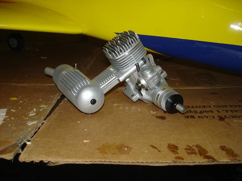

now after looking it says to epoxie the wing on. also im still wondering what would be a good motor to run on the bobcat. im thinking of putting a os 61 on

Wings are intended to be glued on its a one piece model!! You will have to devise your own system if you want to make the wings removable. Its a Goldcat 50 BTW galaxies away from a BVM bobcat. Keep it light and watch the CG. otherwise it will flick in turns if slowed down. Dont ask how I know!! there is a veeery long thread on this model

we flew one the other day, powered with a Supertiger 90. we turned the carb plate on front of engine and now the engine runs opposite direction, clockwise. with that done, you can now use any regular prop. but seems even the 90 is not really enough power. so on mine i have a brand new OS vr-df 90 maybe that will be enough power.
