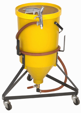

Sean I will shoot some pics when I set up my little blast are, right now I am sacrificing media during the test period but yes it is similar to that. My setup is not nearly as industrial but it is more than adequate for something this size. Below is the blaster i am using. All I am going to do Sean is to make a rectangular frame out of PVC and drape plastic painters drop around it in a shower curtain type of style with a tarp on the ground. I will spray till my media bucket is empty and then collect and poor back into the hopper while straining it in the proper mesh wire (40x40). In the meantime I can post some pics of what I blasted on the A-4 when I get home tonight.

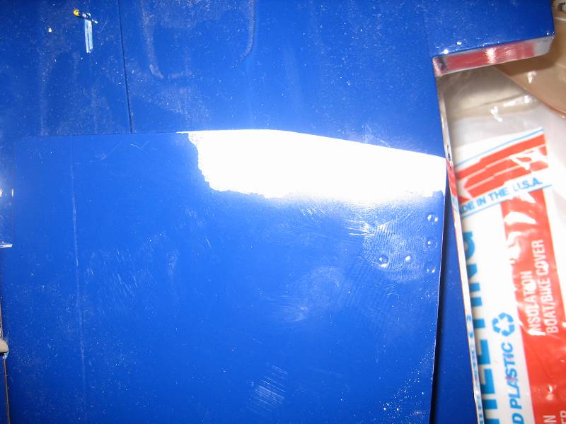

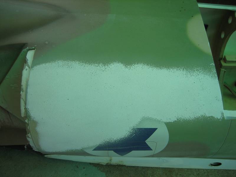

Here are some pics of what I am doing to coral the media so far. Also it may be hard to see but it shows the result of the 2 blasting sessions on some test areas and on the F-18 itself.

The first picture is obviously my "budget" blasting booth. The second picture is my first test with 80 grit aluminum oxide. The second pic is the glass bead. The underlying surface came out pretty much untouched with the glass bead. The third shot is of the f18 and I think it is a little tougher to get the paint off the 18 because it possibly could be a different brand of paint because it seems to be tougher to come off. The A-4 was painted with PPG and flat clear and seems to come off easier so I think I am going to try stepping it up to the 80 grit AO and see if I cant do an initial blast then smooth it out with the glass bead.

Its tough to see in the last one but the rivet detail was saved by the glass bead.

Well I tried the 80 AO on the bottom of one of my flaps and it takes it off a heck of a lot faster that's for sure. I keeps the rivets and what not but it does leave more pin holes that's for sure. I am at a loss here. I am thinking about taking the flap to a professional house and seeing what they can do with it.

ORIGINAL: ianober
Probably not much more than you're doing. Remember, the rivet detail and such is mostly in the gel coat, gel coat is nothing more than a paint coat in the mold basically so it will come off like the paint does. A chemical stripper might work better for you, but I haven't personally tried stripping paint from fiberglass, anytime I've removed it, I've done it the old fashioned way, elbow grease and lots of sandpaper.
