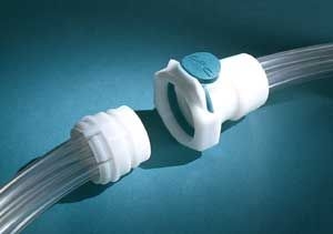

On the old PCM Models L1011 kit, there is a large airline quick disconnect that has provisions for 5 or 6 airlines at once. Does anyone know a source for that disconnect fitting?
It turns out that the nose section of my new Fei Bao F-4 will need to be removable to get it in my trailer... [&:]

Thanks, but I don't think we're talking about the same thing. This is a large (about 1 1/2" in diameter) fitting that connects 5 or 6 indivitual airlines at a time. It "snaps" together to connect them and there is a single "button" on the side that you push to disconnect them. They were included in the old PCM Models L1011 kits because the nose was removable and the entire air system plus the nose gear was in the removable nose, but the main gear and doors were in the fuselage - like the removable nose of my F-4 will have to be.

I remember those from my L-1011. They are called Sixtube or Tentube from Colder Products
http://www.colder.com/Markets/Indust...1/Default.aspx
They have some really neat stuff. The twintube could be great on most jets for retracts couplers

You're brilliant, that's it!

Yea, they work really well on the L1011. If I use one of those for the airlines and a multi-pin connector for the servo lines, then with disconnecting two connectors and removing 6 bolts, I can take the nose off my F-4 and get it in my trailer! BTW, don't anybody say "get a bigger trailer," I was lucky enough to get the F-4 past the wife, but that AND a new trailer is a no sale...
