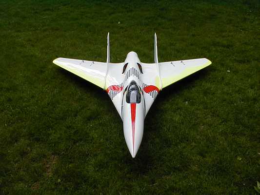

Hi all !!
I just finished up the rookie from composite arf.......I was quite pleased with the kit overall...Most of the work has been completed for you, which makes going from the bench to the flying field a SNAP !!
Any one have this plane? and any suggestions on setting up the thrust vector ??
Tommy

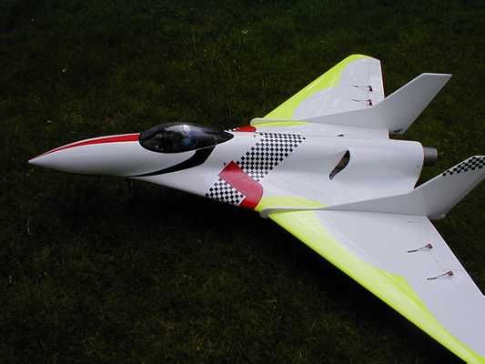

pic 2

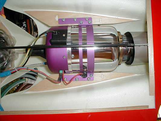

engine hatch

What gear did you use? They advertise as grass field friendly...will you be flying off grass?
The plane looks great! What was your total assembly time?

Default ROOKIE
I USED THE GEAR SUPPLIED FROM COMPOSITE ARF.......... THEY ARE COPIES OF ROBARTS........THEY LOOK EXCACTLY THE SAME. THE ONLY DIFFERENCE I SEE IS THAT THEY ANODIZED THEIR ALUMINUM PARTS BLUE !
I'LL BE TAKING OFF ON BOTH GRASS AND PAVEMENT {WE'LL SEE!!}
TOTAL BUILDING TIME, IF YOU HAVE ALL YOUR EQUIPMENT IS A WEEK ............TOPS !!!!
I HAVE RUN UP THE ENGINE SO FOR, TO CHECK FOR LEAKS, AIR BUBBLES, AND EVERTHING SO FAR IS WORKING FLAWLESSLY !
FIRST FLIGHTS , HOPEFULLY SHPOULD BE THIS WEEKEND........WEATHER PERMITTING !!!!!
THANKS
TOMMY

Another suggestion,
get a FOD screen to protect your turbine. The turbine looks to be somewhat vulnerable with the intakes

Default rookie
I also painted 4 coats of heat shield in the engine and hatch area. Seemed to get very hot back there when I test ran the the motor.
