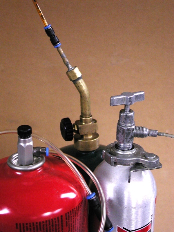

Old 12-05-2008 | 12:21 PM
causeitflies's Avatar
Posts: 2,452
Received 43 Likes on 33 Posts
From: EASTERN OHIO
Default RE: Valve for green bottle propane?
The one in the middle...

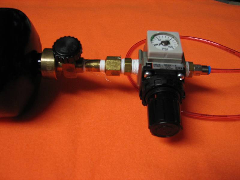

Old 12-05-2008 | 04:57 PM
Joined: Jun 2002
Posts: 114
From: Springfield, IL
Hear is a pict of the valve setup i did for roger, mark And myself.

Old 12-06-2008 | 12:46 AM
Wayne22's Avatar
Posts: 5,394
From: Strathcona county, AB, CANADA
Apparently the green propane bottles have a much higher pressure than the powermax or primus mixed gases, and a regulating valve, such as the one Todd sells is required....

Old 12-06-2008 | 09:01 AM
Joined: Apr 2006
Posts: 350
From: Chatham, IL
My Rhino does not like the regulated one like Todd sells,just not enough pressure to get it going.I made one like the others did out of a propane tourch.I am sure they are still regulated some how,probally some kind of restrictive jet for flow control,but not as nice as a diaphram regulator like Jimbo has made.I also use this on my electric start AMT 280 with no problems.
Joe
Old 12-06-2008 | 11:32 AM
Joined: Jun 2002
Posts: 114
Joe
The one in the picture is a modified propane torch valve the reason for the adjustable regulator was so we could eliminate the onboard propane tank and regulator. This has worked well for Rogers A-10 Marks and my electric and air start turbines.
Old 03-18-2009 | 11:56 PM
Joined: Jan 2006
Posts: 41
From: Mexico City, MEXICO
ORIGINAL: causeitflies
Hi Mark
Today I bought a valve like yours (Bernz O Matic) at Home Depot, but I wonder what mods do I have to make in order to make it work. Can you explain please?
I will really appreciate your help.
Best
JC

Old 03-19-2009 | 05:25 AM
RCISFUN's Avatar
My Feedback: (44)
Posts: 6,930
Received 34 Likes on 30 Posts
From: Erie, PA
ORIGINAL: jcarloslm
Hi Mark
Best
JC
See post #26 in the following thread for the modifications
http://www.rcuniverse.com/forum/m_63..._2/key_/tm.htm

Old 03-19-2009 | 05:31 PM
Posts: 2,452
From: EASTERN OHIO
ORIGINAL: jcarloslm
Hi Mark
Best
JC
JC,
I drilled the orifice out on mine. You may or may not have to do this so try it first without drilling. I don't bypass any of the restrictors, valves or solenoids on the engines. I still have the on-board tank in the plane in case I want to use Powermax and use the normal fill port. The fiitings are just stuff I had laying around. The piece on the end is from the plumbing dept I think for an ice maker ($.85 ??). Just solder or JB Weld the correct size of brass tubing for the gas line or festo.
When starting I first open the valve to add some pressure to the system and then close it. I don't use a gauge. After ignition I crack open the valve and listen to the sound of combustion as the engine spools. I can tell by the sound whether or not I have enough or too much gas. You could use the ECU to determine how fast the temp is rising but I usually just listen. I've never had any flames doing it this way and the starts are smooth. I never tried to fill the on board tank with propane, only PowerMax or equivalent gas mix.
