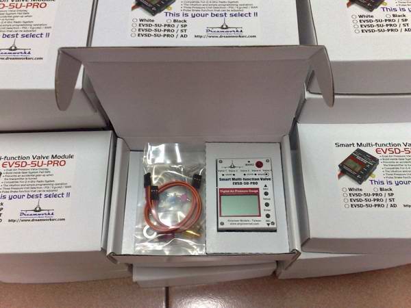

Old 12-09-2008 | 09:57 PM
lov2flyrc's Avatar
My Feedback: (24)
Posts: 6,102
From: Daytona Beach
Default RE: Dreamworks 5 Function Multi Valve Pro
ORIGINAL: Edgar Perez
Todd, when do we get the valve?
My shipment has just left the factory, slightly behind schedule due to some customization for Dreamworks. I should begin shipping pre-orders early next week. Thanks for the patience, this item will be well worth the wait!
