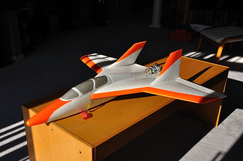

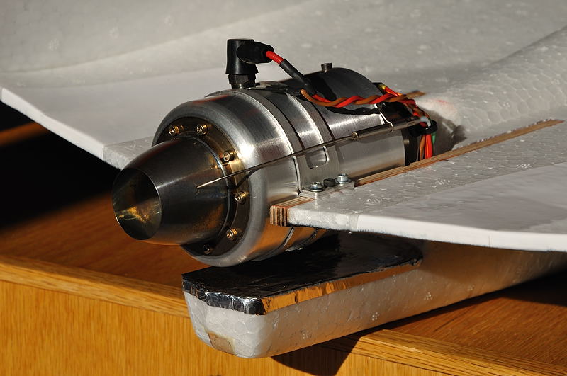

Hi Guys,
Here's my latest toy . I call it the FFF . Fu##ing Fast Foamy ! It lives up to it's name ! I know it's been done before but not in my part of the world
The airframe is a Multiplex TwinJet meant for twin electric motors . Add one Lambert T32 Kolibri and you have maximum jet fun per pound ! The airframe weighs 2lb 15 oz wet and the engine is putting out close to 4 lbs at 242000 RPM . I have 400ml on board and that's good for about 6 minutes .
The engine is manually started with an air blower but a full autostart version is available . I don't see the need because it starts quite easily and runs really well .
During a rare break in the weather we got in a couple of test flights yesterday . Definitely a keeper !

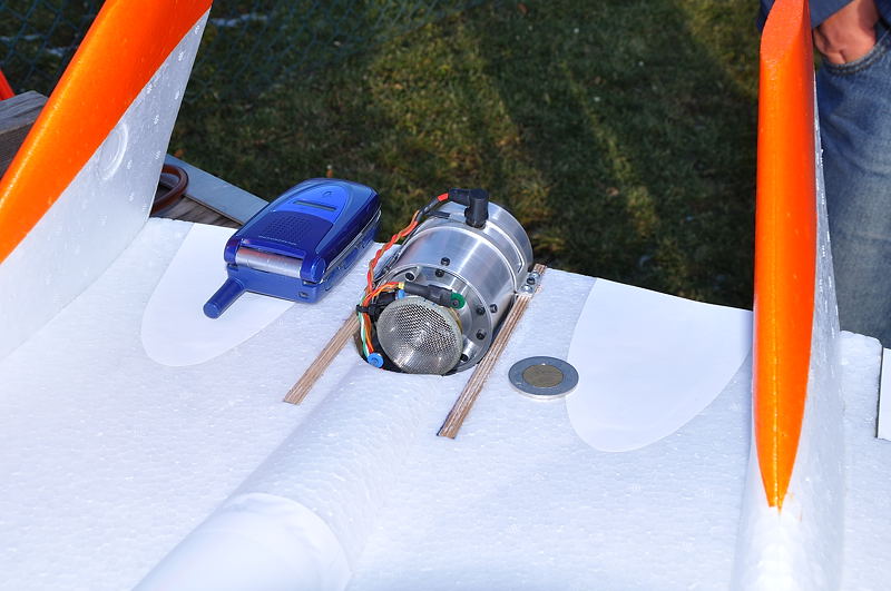

I'm just busy with completing my Colt V-glider with Kolibri again....
I like your FOD-screen, but also make an engine cowling from a bottle neck of a 500 ml water bottle... The diameter of the bottle is a bit larger, but don't worry, cut it through and use a little overlap...
It doesn't cost you anything, it doesn't add weight, but really looks better and moves the TwinJet even faster...

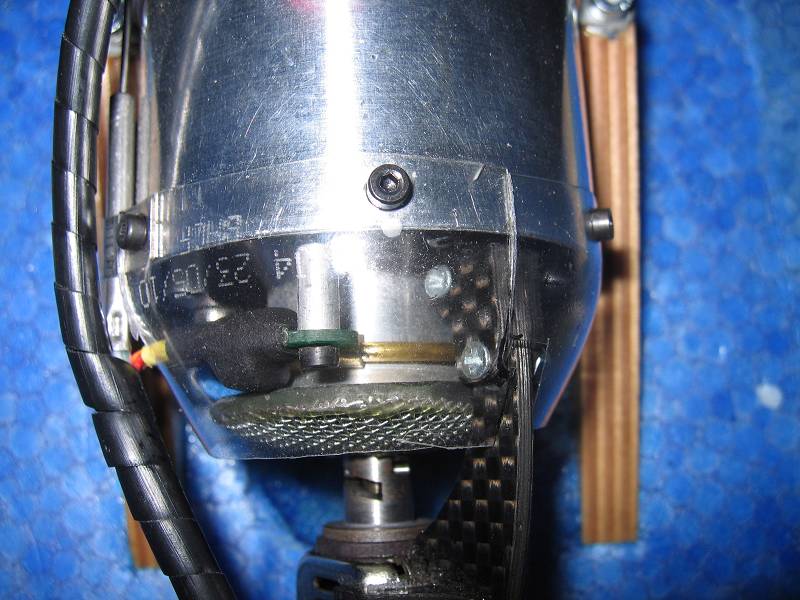

I loved that glider at Jetpower and would love to do that eventually . I'll just play with the TwinJet for now ! Regarding the FOD screen , where do you think I got the idea I used my little CNC mill to cut a ring and glued the strainer onto it . I don't think I'll do the cowl . If you look at my Twinjet , you'll see that I have my motor mounted lower and my elevons are made from balsa to be stiffer . I bet mine is even faster than your's now !![sm=punching.gif]

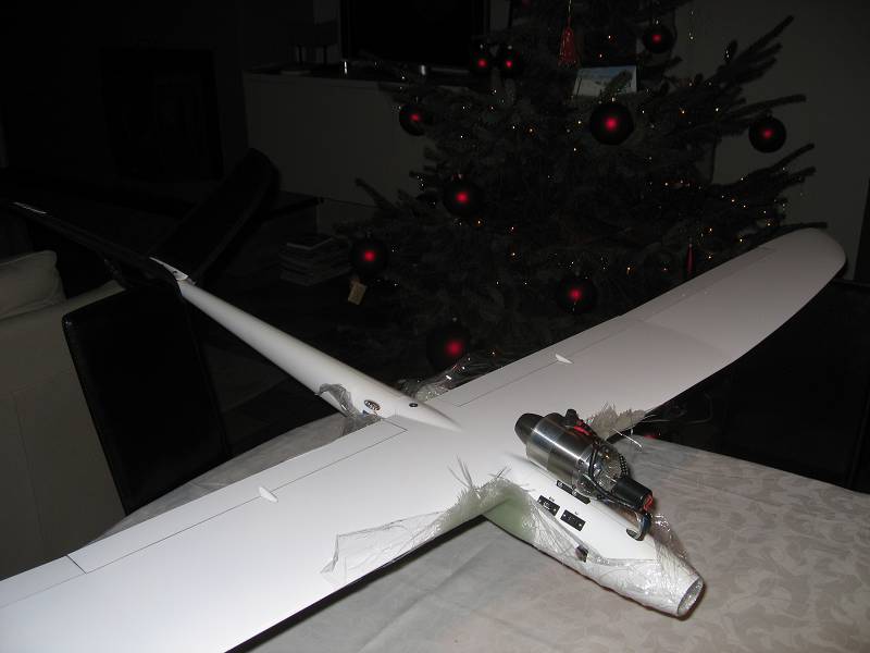

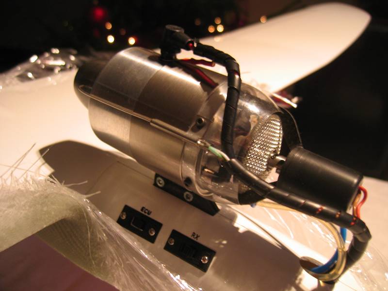

Hi Marc,
Here's one more in my living room right now to make you drool. Just moulding a wheel caddie for it to avoid all these "overwhelmingly-enthousiastic-clubmates-who-wish-to-handlaunch-this-heavy-glider-after-too-many-beers-in-our-cantina" !
Nicolas.

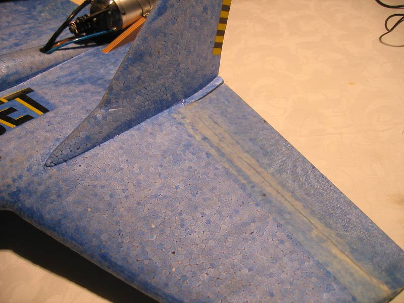

ORIGINAL: 747drvr
Marc
I agree with you, the elevons must be stiffened. Mine were done with one layer of glassfiber (110gr/SQM) top and bottom, with as little epoxy resin as possible.
I bet mine are lighter and stiffer than yours !!![sm=punching.gif]
