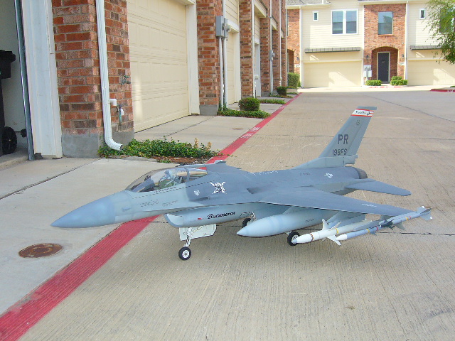

These are some of my F-16's, both aileron and taileron: (The Cermark with the Edwards schem has been the most fun so far, doesn't get any simpler than that!!)
