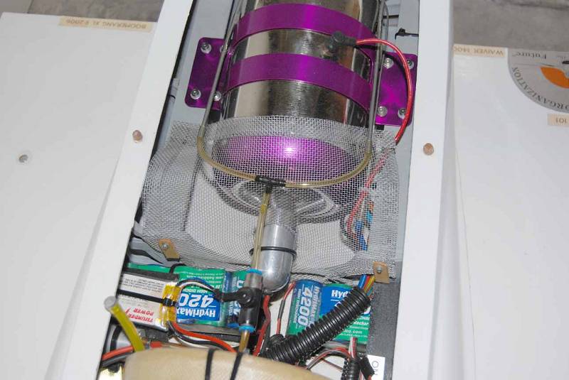

I have been running a large mesh screen over the whole former in front of my engine in my Big Boomer XL II. Does the job for me, especially if I am flying on a grass field.
Roy
