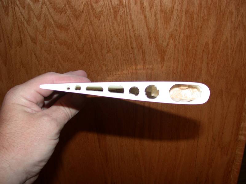

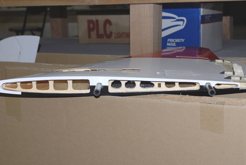

on one of my TamJet A-4s i shaved over 1.5lbs by trimming formers and opening up lightening holes further.
