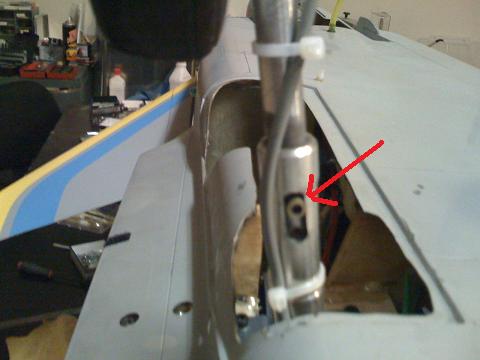

Today I lost the little screw which acts as a stopper on my Gripen nose strut. (see pic of the part on one of the main strut). Anyone knows where to get one? I have an older Skymaster Gripen. I'm not sure what brand the struts are.
Arnaud

prob. its a M4 hexagon.
the "round" bit was turned down to fit the oleo,s thats how we do it..

Arnaud, if you need one turned down I can do that on my lathe for you buddy. I have the same screws in my Skymaster F-15 so I can check the threading and fit.

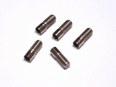

Dear Sir,
Please check it !
http://www.airpowernet.com/twe/produ...roducts_id=591
AirPower

Being of the impatient kind, I have re-tapped the strut to a 8/32 size and used a modified 8/32 bolt. It works with very little play.
Thanks for all the answers.
