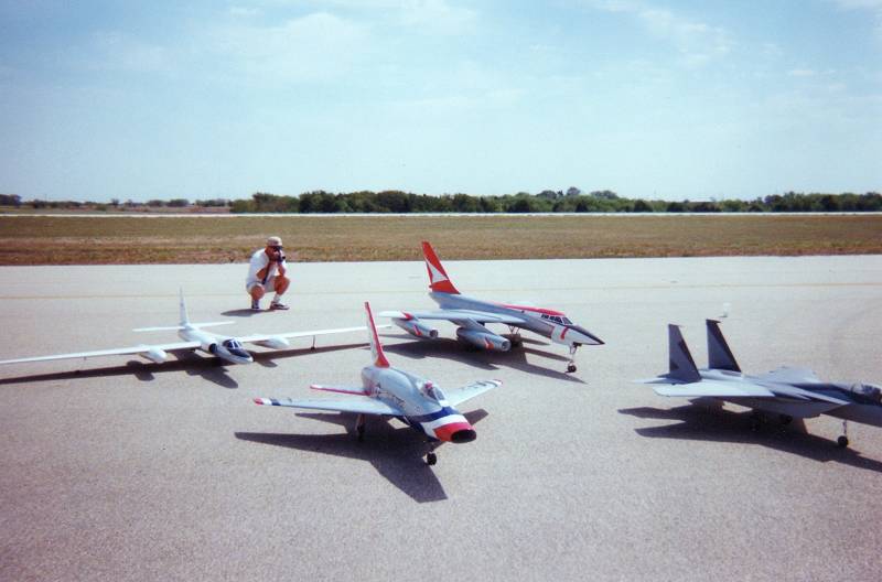

Just FYI. The F-100 in this picture is what the BVM F-100 is built after. It weighed 35# and flew on a Ducted Fan. So I think you will have plenty of thrust.

Whew, love that Hustler in the background. I know that most of you gents like to have a little more power to spare,
unfortunately, this is all i can afford right now, so i have tried to cut the weight with any unnecessary items. From
all of the expertise opinions from you gents, i am confident that it is plenty there to push this old bird into the sky. Just that
i can't stand her on her tail for long or dances across the sky like that jet vid i saw here yesterday. . Again, thank you all
