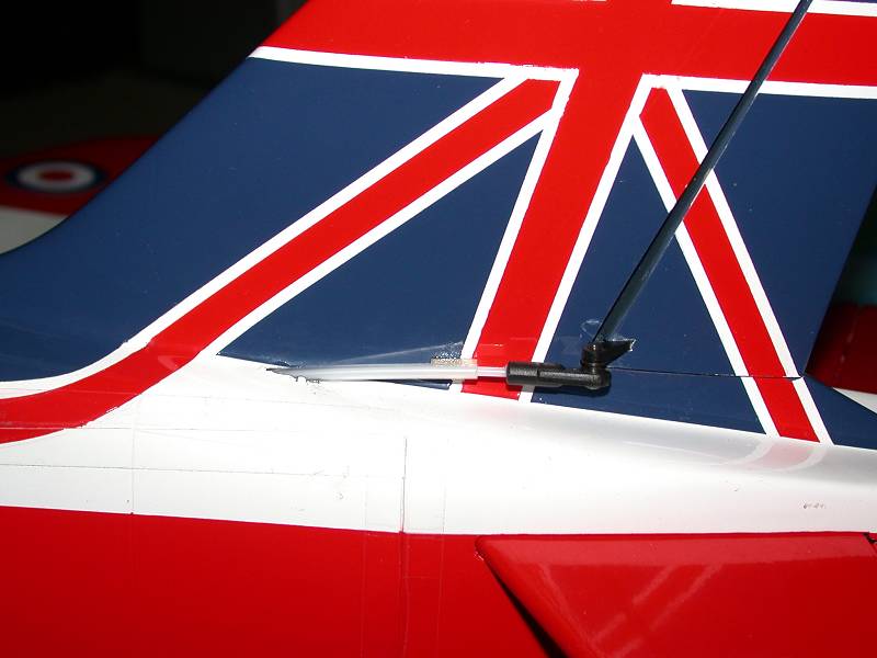

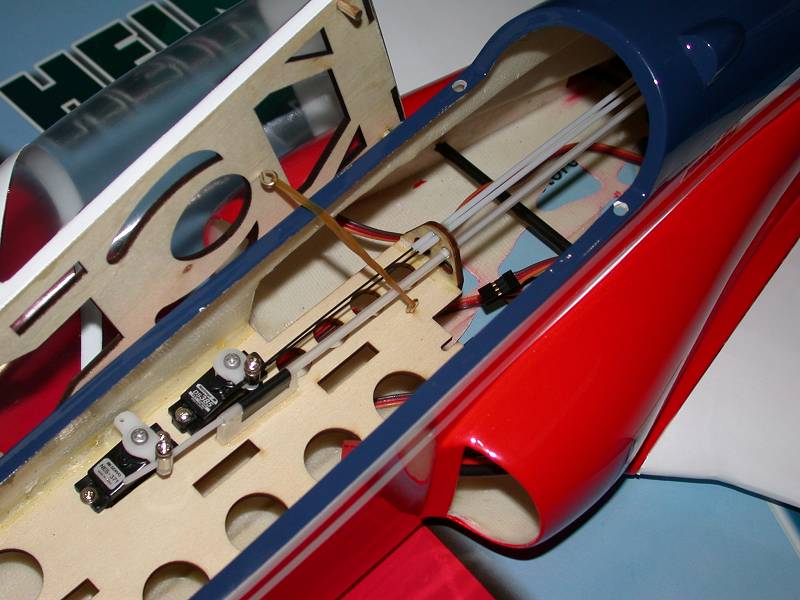

Guys
Just finishing an EFlight Hawk, We already have a couple flying around our team in stock configuration, nice aeroplane on 4s.
Seeing Hawks always KE so well, I decided to fit a rudder on my example.
I used the 35/72mHz aerial tube as the rudder snake and Razor saw'd the Rudder out before lining with balsa.
I'll let you know if it's worth the effort when I finish and fly it
Dave W

Can take as many as you need-what do you need more detail on?
I cut the rudder out (Razor saw 24TPI) on the scale line, used a 1/4" fun post in the fin and 3/8" in the rudder to allow for bevel.
3 cyno hinges, MA helicopter ball link (because of raked back fin)
Regards
Dave

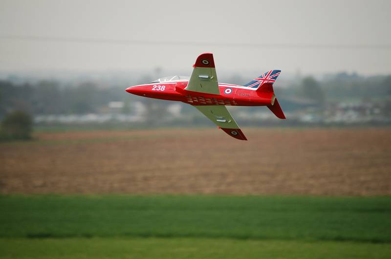

Finally flown the EF Hawk with rudder, our grass still stopped the dolly working, so with my only trusted launcher still AWOL I decided to get someone else on the sticks and I would launch before taking over. Two flights today.
Yes the rudder is worth it, long slow rolls and knifedge passes are all possible now. Actually and really nice flying aeroplane!
4s 3200 cells and I'm getting 5 minutes flat chat
Dave W
