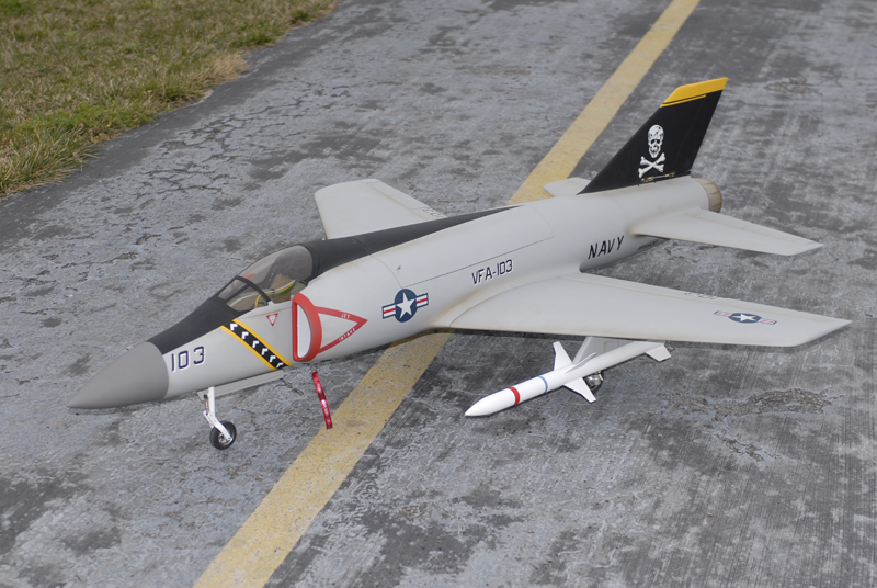

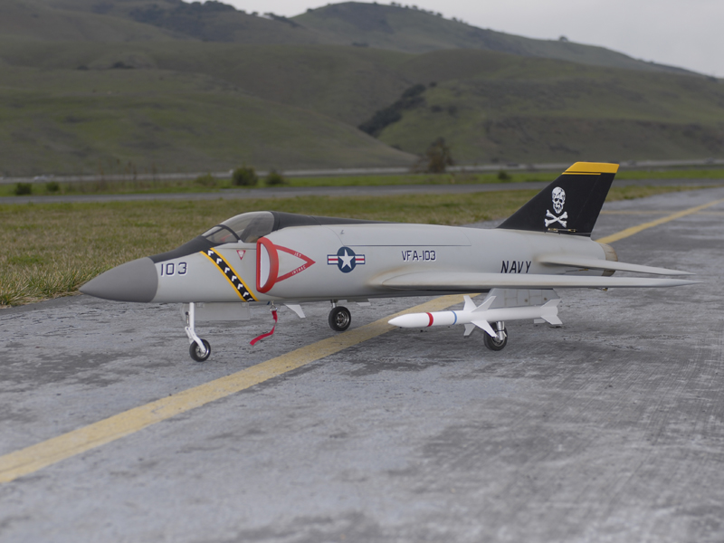

Here is the Yellow Aircraft StarFire with the new conversion kit we did.
I got 4 flights today with TJ100 EDF power plant. It was an awesome plane.
The plane weight 13.5 lbs with 10s 4450mAh set up.
The 12s 5350mAh weight 14.35 lbs.
Both set up flew so well.

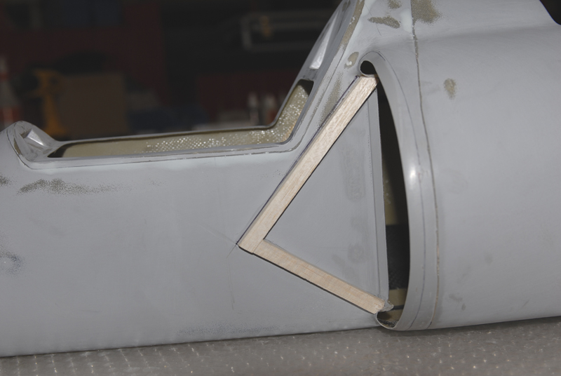

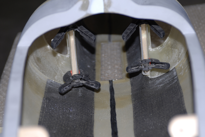

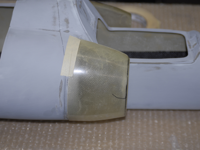

Extension the intake duct.

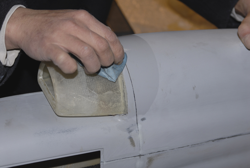

Sand and fill the gap.

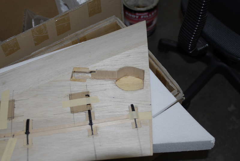

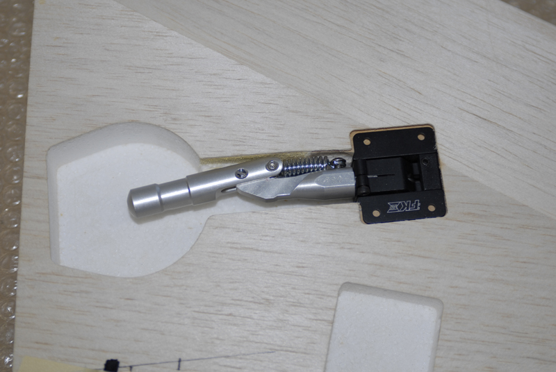

Flaps hinges, pylons and gear installl.
