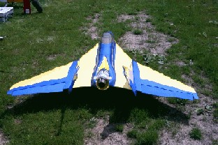

Just curious, I am designing a delta wing jet that I want to fly with elevons only (mixed elev/aileron and no other flight controls besides rudder)
On a plane such as the Kangaroo, how large are the individual elevons? (total length and width of the moveable surface)

I am not at home to measure mine but as a guess, it is about 18"long by about 2 -21/4 wide.

The elevon on my HotSpot measures 18 1/2" long at the leading edge and 17 3/8" at the trailing edge. The chord is 4" at the root end and 2 1/2" at the tip end.

Thanks guys for the replies - that is wider than I had thought but I guess you need that much for proper elevator authority.

Leading & trailing edge length = 20.5" & 20.0"
Root width = 4"
Tip width = 2.5"
