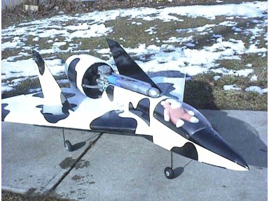

Just thought I would post a couple pics of my buddie's Enforcer that I just finished building for him! For anyone wanting to get into DF aircraft, this plane is probably the easiest and definitely cheapest way to do it!
This particular plane has an OS .91 and Robart retracts.
My buddy calls this plane "Mooooovin' "and I think you can probably figure out why!

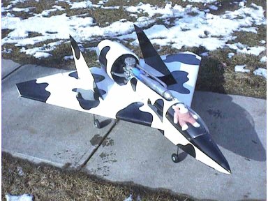

Just another pic a little closer. As you can see by the ground, winter is slowly leaving us!

Nice job,
Do you guys live on a farm? The spots on the Moooooven Enforcer sorta look like the Holstein (No relation) cattle we had, when I lived on the farm as a kid!
Looks kool tho.

Hehehe! Actually no, neither my buddy or myself live on a farm. I do live in an area that has a lot of farming going on, but I try to stay away from that!
I actually just took a guess on the pattern after seeing a cow on my way to work one morning!
I like things a little different!
Hmmm, I wonder if anyone would be brave enough to paint their Kangaroo or Hot Spot in this way!???
Even the pilot is a little cow as well!

Ha HA , thats great! I didn't notice the "little" Moooo-ver in the cockpit! :thumbup:

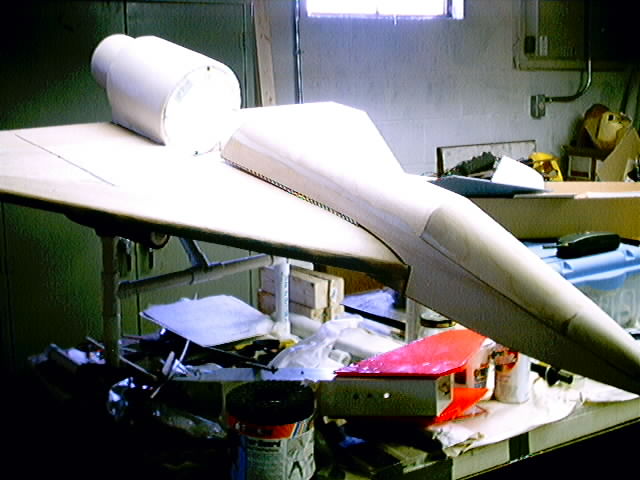

Looks Udderly great, lol, let us know how it flies. I have one under construction. Here is a picture of the progress.

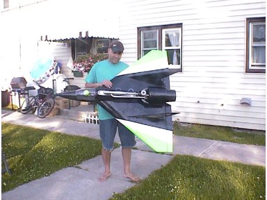

Just thought I might as well post a pic of my Enforcer!The "Alienator"
b17flyer,
Which mechanical retracts did you use?
I have an older set of Rhom air in this.

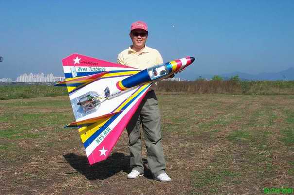

Hi,I am enjoying to fly my Enforcer with Wren Turbine Engine MW54N.
It flies great and really fast and fantastic. Every manuvera are just alright and quite tamed.
I had 40oz dubro tank and small hopper tank. I tuned the engine with Orbitronics ECU with manual start. Every time starts perfect. Already more than 40 sorties in the riverside grass runway just in front of many mania and gallery. Everybody could not shut the mouth hehe.
Please let me advise to anyone who wants to get my experience.
I am building now F-14 from scratch 1/10th scale based on Hobby Barn plan. It is going well and finished swing wing system.
I am going to put twin turbine engines on this plane for the exciting speed.
Good luck to anyone who get Enforcer. It is really nice trainer!!

My Enforcer has weight around 5 kg dry and 5.5-7kg wet.
The MW54N has around 4.5kg-5kg thrust. I measured it by spring scale on the ground, thus it might slightly more upto 5kg.
I would recommend to start by new kit if you wish to build Turbine Trainer, because the kit from Balsa USA is quite cheap around 100 bucks only. Covered it by Monocote and Urethane clear.
I did all planking for the safely of high speed but try to keep the elevon tight without slop. I put two JR digital servos and quite good in control.
In low pass with maximun rpm of 160,000, it looks too fast to chase it even by eye hehehe! It flies like bullet.
I decided to re-design fuselage to make more room for fuel tank of Dubro 40oz. and some mechanical retracts. Also I made nose a little longer for nose gear and room for electronics. However, I did faithfully keep the elevon as guided in manual.
I hope this is helpful to you.

That's a great looking Enforcer. I can see why the crowds would be wowed. Be sure to post pics of your F-14, as that sounds good too.
