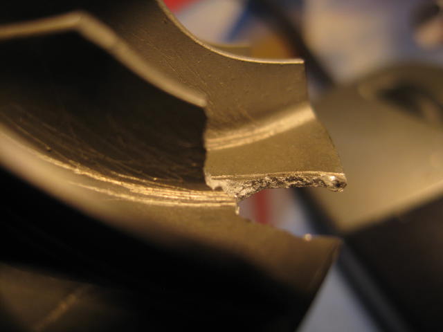

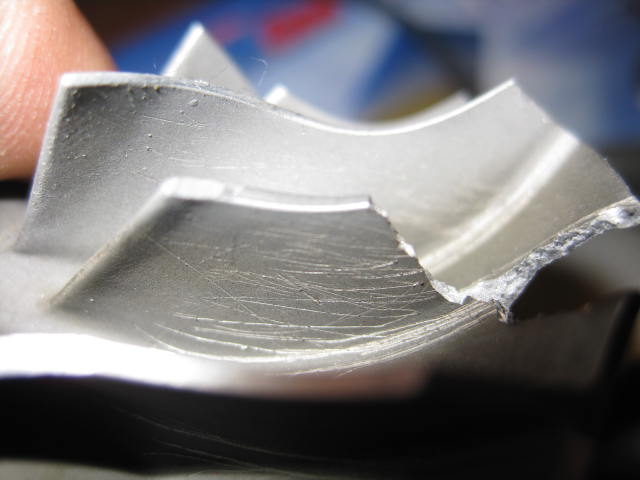

HI all, I sent my Ram 1000 in to get new bearings and balancing, as their was a slight vibration at 60 tho.
Was told before the work was started at the compressor wheel looked like it might cause the turbine to cavatate.
Bearing where put in and when the turbine was ran to over 100tho, it cavated and the compressor let go.
The purpose of this tread, is to find another compressor and see if any one else has ever seen a compressor wheel let go like this one.
Rcpete

I have never seen a wheel fail like that. Can you post a better picture of the last one you have posted. Try to zoom in as close as you can. There must have been a void in the wheel.

HI, their is no void.
Rcpete

I've seen a few turbo compressors do exactly this, and it was typically caused by either FOD or over-revving... or a combination of both.

I find it interesting that there is a shiny area on the tear, this material will not do this under normal circumstances, is that really like that or is it just the pic? If there is a void or crack, it could be very tiny and hard to see. I would imagine that this would be close to the leading edge of the blade, as the tear propagates back to the hub, the centrifugal force would make this section rotate as it comes out, the leading edge of the blade would hit the bell mouth forcing the broken section out through the back of the compressor, as you can see in the pic it has the bent back portions on the side . What does the bell mouth and diffusers look like? I imagine there done.
That is a very old style compressor is this what come with a Ram?

I could see over revving but would the fod make it past the inducer?

I had a RAM750 that came apart on me and the compressor had chunks missing that were pretty similar looking to that one. Don't know why it came apart, if the engine had ingested FOD before I owned it or what had happened.

I was on the fourth compressor in nine years and about 600 cycles when my RAM750+ screeched to a halt a week ago. My first thoughts were "not another compressor" gone but this time the rear bearing had failed catastrophically and now the motor is probably not worthwhile rebuilding.
The characteristics of the three failures my Ram compressors had were basically identical except the part of the vane that failed on #1 did not break off. Also interesting to note that the failures happened at approx. 180/360/540 cycles indicating fatigue as the most likely culprit. We used to joke that the next one was expected at about 720 cycles but now I don't think we are going to get there.
Had a great ride with the Ram and all happened on the same Kangaroo.

I should have also added that #2 & #3 failures occurred with a screen fitted to stop FOD. After #2 failure, we set max. rpm at 105,000 from 120,000, and after #3 failure, we set max. rpm to 95,000. So even with the lower max. revs the compressors continued to fail. Kangaroo performance was down a bit but still OK. Flying only off full size bitumen runways was a big help.

I would say this is pretty good evidence as to what happened to yours and with all exhibiting the same end result. I think jet log's first pic showing the beginning of the failure is very revealing. Just picture that break continuing and leaving you with the half-moon shaped piece missing from the outer hub with bent back edges. And given the fact that his last two occurred with a FOD screen eliminates that cause; leaving the RPMs as a main focus. Maybe these older wheels had a problem or were never designed or intended to be spun that fast.
