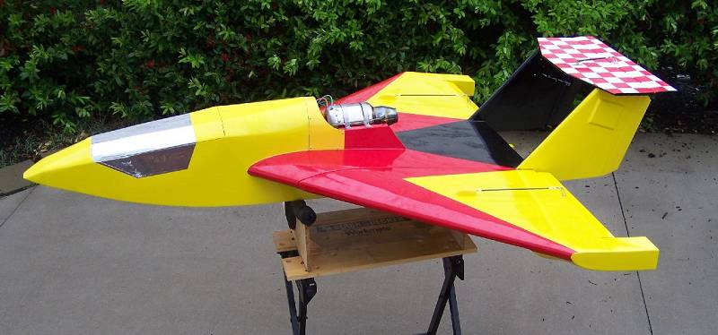

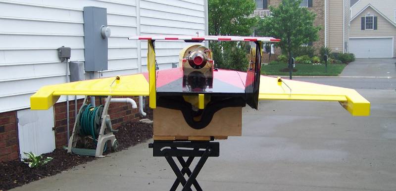

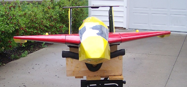

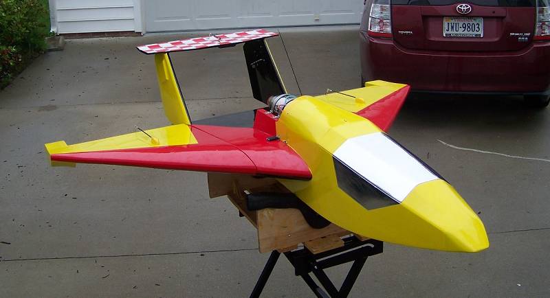

Here's our latest project - a turbine-powered "Northstar." The basic shape is the same, but it has been enlarged by about 130% and highly modified for turbine power. Its got an AMT-180 airstart, 8611 servos, Futaba FASST, and 100 oz of fuel on board. Dry weight is just under 18 lbs.
It was built by Don Koonce here in Richmond and I supplied the turbine and RC gear. We know its a bit "unusual" looking so to say, but seaplanes are rarely "graceful." The original has a lot of flat surfaces that didn't look like they would be strong enough in the larger version, so they were angled for more strength. It looks like it will fly OK though...
Hopefully the test flight will be this coming weekend and it will be on the pond down at the Joe Nall the weekend after that...

It looks like the turbine may have some trouble getting intake air at high speed?

Interesting plane. I suggest doing something to protect the elevator and rudder servos & linkages from exhaust heat. Also use metal servo arms for the rudders. Aluminum furnace tape on the bottom of the stab would protect it. If you ever have a hot start you'll fry that stab.

I was originally going to put the turbine in a complete tunnel like the one that in the thread posted above, but I was worried about it being able to get enough air, so that's why I cut the top back so that the front of the turbine is exposed. It gets enough air to run OK statically, so I think it will be OK at low speeds and its not really built for super high speeds anyway so I intend to keep it fairly slow. I'm hoping that there won't be much, if any spray that goes over the top and gets sucked in. Its a draggy airframe anyway (thick wing, boat hull, etc.) so I doubt its going to be very fast.
Its all an experiment! I'll keep you guys posted on how it goes... [8D]
Bob
Good luck with the maiden.
Joe
Joe,
I'm going to use the stove pipe that we have for Louie's Reaction 54 just in case, but its pretty hard to get a hot start with an air start engine if you have a really good air source (which we do). I'm going to check the temp of the rudder and stab servos after running it for a bit on the ground and I'll protect them if they seem to get hot - they should stay much cooler in the air.
Bob
ps. Now that I think about it, I was going to put guards on the rudder linkages like I did for the ailerons, primarily to keep spray out, but now that I think about it, I think that they would also help keep the heat off of the linkages too, so I'm going to add them to the rudders as well...

Don't laugh but.....don't forget to remove the exhaust plug!!! i bet you wouldn't be the last person to forget to remove the tail plug.

Oh, I was thinking that if I left the plugs in, it would help keep the water out... With a dry weight of only 18 lbs, I won't need that much thrust, so I figured I could sacrifice some. How much thrust would I get from an 18 lb engine if I left the plugs in?
